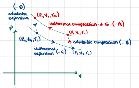

Suppose an inventor claims that he/she can do the following.
Using only the heat exhaust from a refrigerator and an unlimited supply of liquid nitrogen, he/she can generate more energy than his refrigerator uses to operate.
The refrigerator is an ideal heat pump that keeps its contents at 275K by pumping out exhaust at 304K.
The inventor uses an ideal heat engine to generate work from the refrigerator's exhaust.
Liquid nitrogen at 75K is used to cool the heat engine.
Calculate
a) refrigerator efficiency
b) heat engine efficiency and ##|W_{eng}|## output by the engine if the refrigerator uses 1570J to run
Note that there are other further items in the original problem but my question is about the calculation of engine work in part b).

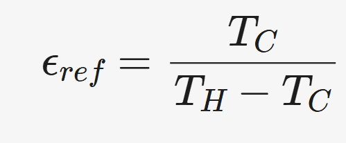

The efficiency of a heat pump is
$$\mathcal{\epsilon}_{ref}=\frac{T_C}{T_H-T_C}=\frac{275}{29}=9.48$$
where ##T_H=304K## is the hot reservoir and ##T_C=275K## is the cold reservoir.
The efficiency of the heat engine is
$$\mathcal{\epsilon}_{eng}=1-\frac{T_C}{T_H}=1-\frac{75}{304}=0.753$$
where now we have a hot reservoir at 304K (the exhaust from the refrigerator) and a cold reservoir at 75K (the liquid nitrogen).
Schematically, here is the reverse Carnot cycle that represents the heat pump (ie, the refrigerator):
Note that I am naming the individual processes as -A, -B, -C, and -D because the corresponding heat engine has processes A, B, C, and D.
The refrigerator uses 1570J to run. This is the work required in order to obtain a certain amount of heat from the refrigerator's cold reservoir.
Let's denote this certain amount of heat as ##|Q_{-C}|##. This is the absolute value of the heat flow in process -C in the picture above.
Then
$$\mathcal{\epsilon}_{ref}=9.48=\frac{|Q_{-C}|}{1570\text{J}}$$
$$\implies |Q_{-C}|=9.48\cdot 1570=14.8\text{kJ}$$
As far as I understand, this is not the heat exhausted by the refrigerator. This is the heat removed from the cold reservoir.
The heat exhausted is the heat in process -A, namely, the heat that is transferred to the hot reservoir.
1570J represents the total work in the cyclic process.
$$|W_{pump}|=1570\text{J}=|W_{-C}+W_{-A}|=|-(Q_{-C}+Q_{-A})|$$
We can calculate ##W_{-C}## and ##W_{-A}## and show that ##W_{-C}+W_{-A}=-(Q_{-C}+Q_{-A})>0##. Thus, we can remove the absolute values and so
$$Q_{-A}=-Q_{-C}-W_{pump}$$
$$=-9.48\cdot 1570 - 1570=-10.48\cdot 1570$$
$$=16.45\text{kJ}$$
This is the heat exhausted by the refrigerator.
The work done by the engine is then
$$|W_{eng}|=0.753\cdot 16.45\text{kJ}=12.39 kJ$$
This problem is from EdX and has automated grading. The answer for this last calculation is, according to EdX, 11.2 kJ.
I am wondering where the discrepancy comes from.
More importantly, I am wondering if the reasoning I used above is correct?

in this formula if Tc is very close by Th, then Th-Tc->0
and the result goes to infinity. isn't that weird?
  • Skeptical
No, it's not. Why would you think it is? It's saying it gets easier to move heat if you have a smaller temperature difference. (Heat pump efficiency).
