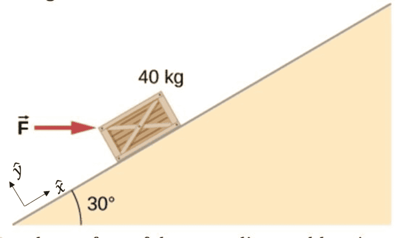

Shown below is a 40-kg crate that is pushed at constant velocity a distance 8.0 m along a incline by the horizontal force F. The coefficient of kinetic friction between the crate and the incline is u_k = 0.4 Calculate the work done by (a) the applied force, (b) the frictional force, (c) the gravitational force, and (d) the net force.
F = ma
For part a and b, I can't see a clear path to finding the answers. In order to find the x component of the applied force I need to know the friction. In order to find the friction I need to find the y component of the applied force, but I can't think of a way to find either.
I thought of trying to solve it by considering energy but without knowing the velocity and given that friction's involved is that even possible?
If I understand correctly Work(Force applied) + Work(Gravity) + Work(Friction) = 0? But how can that lead me to the answer?

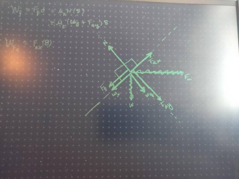

I can't see clearly what you have written in that diagram. I'm also not sure what you don't understand.
Suppose the force ##F## was up the slope and there was no friction. Could you answer the question in that case.
Unless the block gains KE, then the net work done on it is zero.

Yes, if there was no friction, I think I could solve it. Is there a way to solve for the work done by friction using energy considerations so that I don't need to know the components or magnitude of the friction force?
You have the coefficient of kinetic friction ##\mu_k.## What equation do you know that gives you the force of kinetic friction in terms of it? Look it up if you don't remember.
You have to resolve the forces into components tangential and normal to the slope. You should not be reluctant to do this.

Ok so as a starting point I have:
$$N+w_y+F_{ay}=0$$
$$F_{ax}+\mu_k N+w_x=0$$
Does that look correct?

Yes. And in there you know the relationship between the x and y components in each case, so the only unknowns are N and F. Manipulate them to eliminate one and hence find the other.

EDIT. I think you have sign errors in those equations. All the forces are positive...? What is your positive coordinate system ( i.e which directions are assumed positive)?

I tried to set it up so that N would be in the positive direction y and downhill would be in the negative x.
Is this what you think you are using as the coordinate convention?
Yes that's correct. That's what I tried to do at least
yeah, but you are only getting the sign of 1 of the 3 forces correct in each equation...
in the x direction do you think friction and weight point up the hill in positive ##x##? Because that is what your equation says.

I see the friction in my equation has the wrong sign. I had set ##w_{x} =-196## so I believe that should be correct?
Sigh ...I've redrawn the free body diagram so many times and tried to manipulate the equations I guess wrote them down wrong or did the diagram wrong at some point.
But I can see with your advice of writing the components of F in terms of the magnitude(F) and sin and cos that the system of equations must be possible to solve.

But you did not eliminate N. Write one equation in the form ##N=##some expression not involving N, then use that to replace N in the other. This is standard technique for solving simultaneous equations.
