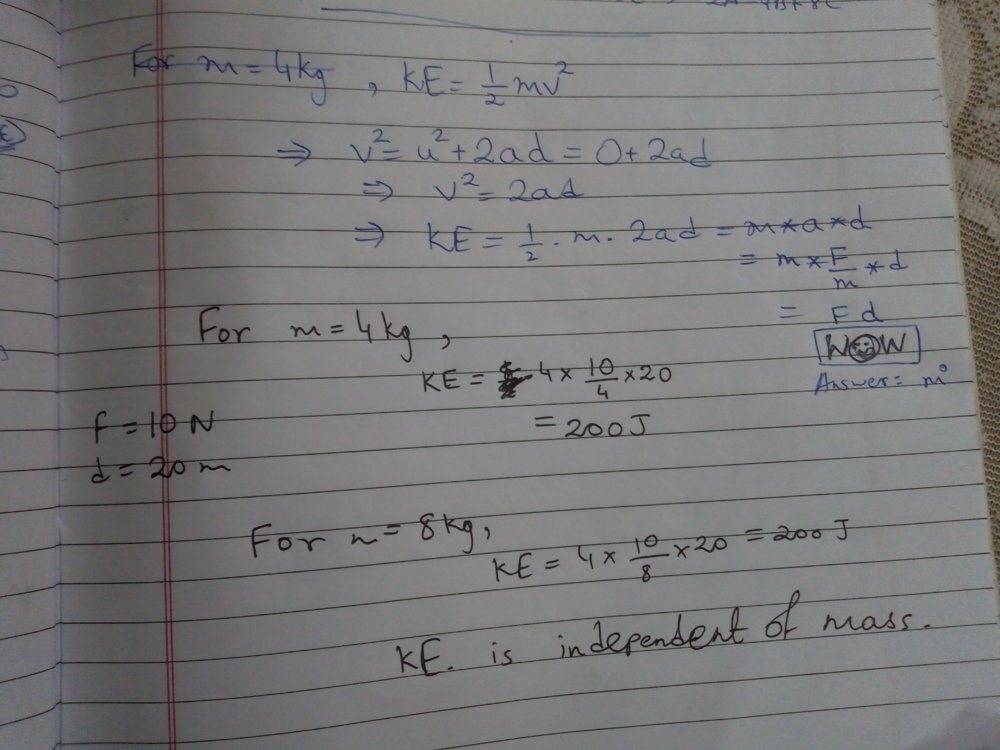

The kinetic energy acquired by a mass m in travelling distance d, starting from rest,under the action of a constant force is directly proportional to
1.m
2.m to the power 0
3.m to the power 0.5
4.m to the power -0.5
1/2m(v² -u²)=F*d
F=m*a
v²-u²=2a*d
Initial velocity u=0
Let Final velocity be v
Then, KE acquired by the object=1/2mv²
So the answer must be option1 i.e. m¹
But my textbook says the answer is- m to the power zero.Please explain this discrepancy.

Your answer says that the greater the mass the greater the kinetic energy. Is this what you mean?
How do you interpret the book's answer?

You must look at how the KE changes if the mass changes, assuming that the force and distances remain the same. How does the value of the KE change if you change the mass but keep F and d the same?
If it is not clear, try with some number, say F=10 N and d=20 meters. Assume m= 4 kg. What is the kinetic energy acquired? Now if you have a mass of 8kg, what will be the change of KE this time?
Part of the issue seems to be in determining which other quantities are dependent on mass. For a fixed velocity, KE is indeed proportional to ##m##. But in this problem, the acceleration and by extension the velocity after any given distance is also related to the mass.
You want to find a relation in which everything apart from KE (and ##m##) is independent of ##m##.
Thank You verrrrrrrrry much nrqed 😁.
That was a fantastic explanation.Miraculous .I Love Physics...

Uhmm ... E = F d. Neither F nor d depend on mass. QED.
