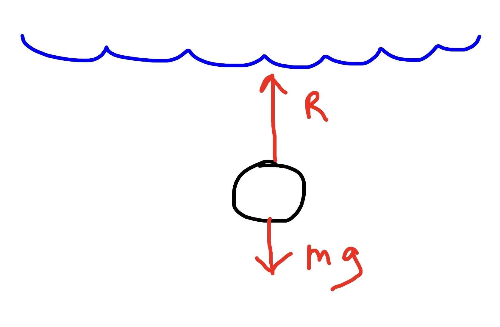

for (b), the resistance of 3N on the ball as it sinks is not the net force
Can you pls show how to calculate. Iam not able to understand
what are the forces acting on the ball as it sinks?
The forces acting on the ball is the final KE, final GPE and the resistance
So 11.62- 0.459h-8= -3h

from the very beginning ...
A golf ball of mass 45.9g is hit from a tee with speed 50 m/ s. The ball lands in a pond 5m lower than the tee. When the ball lands in the pond it has traveled a curved path of length 160m. The resistance acting on the ball has magnitude 0.3N
a) Find the speed of the ball just before it hits the water
let the zero for GPE be the water level
$KE_0 + mgh_0 - R_1 \cdot s_1 = KE_f$
where the magnitude of $R_1 = 0.3 \, N$, $s_1 = 160 \, m$
The water immediately absorbs 8J of energy from the ball. The ball then sinks vertically downwards to reach the bottom of the pond. The resistance acting on the ball had magnitude 3N and the ball just comes to rest as it reaches the bottom of the pond.
b) find the depth of the pond
$KE_f - 8 - (R_2 - mg) \cdot s_2 = 0$
where the magnitude of $R_2 = 3 \, N$ and and the weight of the ball, $mg$, is not 459N

Part b) Using romsek's notation in post #12:
It's the Work-Energy theorem.
[math]W_{net} = \Delta KE[/math]
Step 1: The work done by gravity as it sinks: [math]W_g = mgh - mgh_0 = -mg s_2[/math]
Step 2: The work done by the water: [math]W_w = F s_2 = -R s_2[/math]
Step 3: 8 J of energy is absorbed by the water so there is an extra work done of 8 J.
Step 4: Using the final kinetic energy from part a) as the initial energy of part b):
So
[math]-mg s_2 - R s_2 + 8 = - KE_f[/math]
which is romsek's equation.
If you are still confused, what part are you still confused about?
