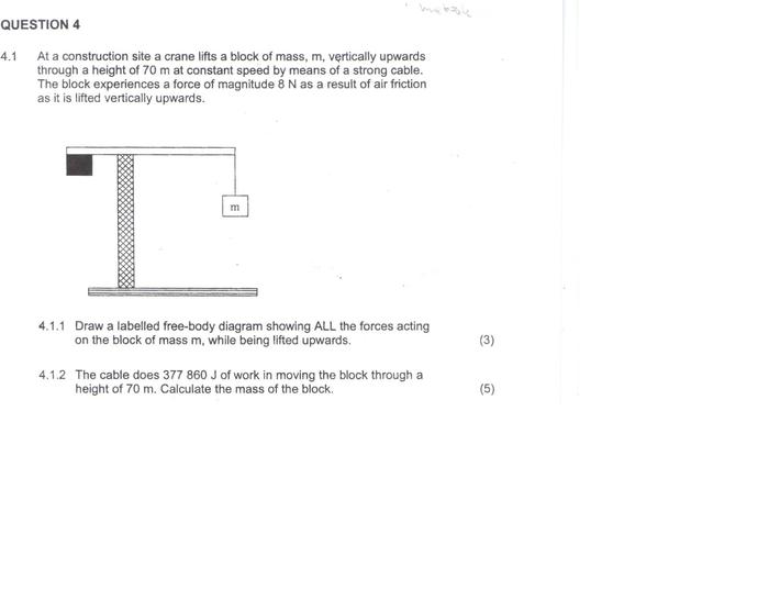

W=F*delta x
Fg = mg
I just want to know if my answer is correct for question 4.1.2:
W=Fapp*delta x
377860 = Fapp*70
Fapp = 5398N
Fnet = 0 (constant velocity)
Fnet = 0
5398-8-Fg=0
Fg = 5390
Fg = mg
5390 = m*9.8
m = 550kg
Correct ?
So is everything correct and the mass is definitely 550kg ?
Why sure, your work is good.
