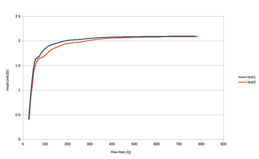

Hi All,
Thank you for taking your time to look at my question. I am a web developer and have created a online system that produces graphs but cannot understand how the line of best fit (trend line) is calculated. On paper its easy, just draw it with your hand in between the two lines. But I don't know how to work this out using the values I have.
My Task:
Workout the flow rate (Q) of a pumping station. In other words find out how fast the water reduces in a well from the top to bottom.
Physical Process:
The engineer records the water level at the top of the well. At set intervals he/she records how far the water goes down until it reaches a certain point at the bottom.
My Working out:
I have the time and water level from the engineer. Using this information I work out the change in time at every level recorded and calculate the flow rate. I know how to do this, that's all done.
Now I need to plot flow rate on the x-axis and water level on the y-axis. Once plotted it looks like this:
The only thing I am stuck on is drawing the trend line (line of best fit).
How can I do this using the level and flow rate values I have? Please help me?

I have several comments:
1. It looks like you've plotted this data in Excel. If so, right-click the actual data in the scatter plot, and select Add Trendline. Make sure you pick the function that's closest to what you want, and Display the Equation and the $R^2$ value (measure of how good the fit is).
2. It doesn't look at all linear to me. It looks more like exponential approach to me. You could fit a straight line to it, but I'm not sure how valuable that'd be. I'm not sure Excel can fit an exponential approach, but you can always jury-rig it with the Excel Solver routine.

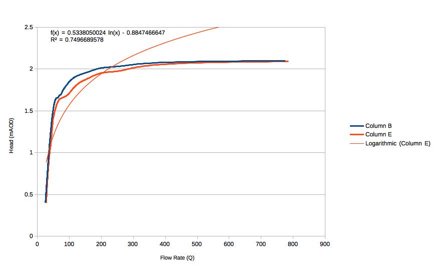

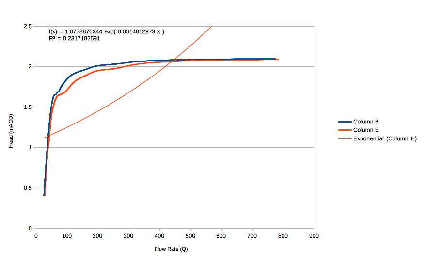

Many thanks for getting back to me. I've plotted the graph in excel, my program produces the same. I've tried to add trend lines in excel but I don't get the curve I need.
In these examples the two tests are almost the same but there will be occasions where one curve will be a lot lower than the other. This is why I need to work out an average that goes in between them. Therefore the average line can be used.Using excel this is what I get with a 'exponential curve':
This is what I get with a 'Logarithmic curve' (The average is outside the two tests, not in between):

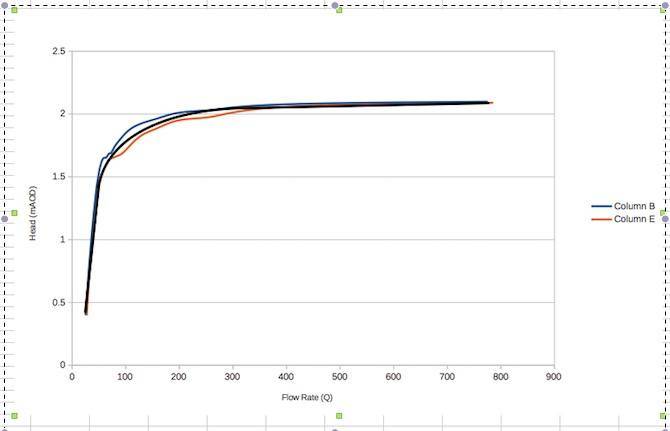

View attachment 2743What I'm really asking is , is it even possible mathematically? I have looked into 'least squares method' but that did not work either. Is there a method in maths out there can can be used to solve this? I just need to know what that method is, I can read up on it and work it out.
This is what I need, I've drawn this using a curved line in excel. Is there a way mathematically to achieve this?

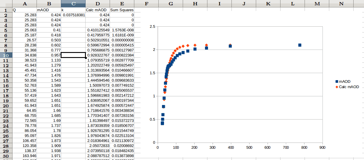

There is a way to do this with least squares. The issue is that the kind of function you need to assume is not present in Excel's lineup. I would think a function of this kind would fit well:
$$\text{mAOD}(Q)=\text{mAOD}_{\text{final}}-(\text{mAOD}_{\text{final}}-\text{mAOD}_{\text{initial}}) \, e^{-k(Q-Q_{\text{initial}})}.$$
How did I get this function? Well, I essentially just copied the form of the solution of Newton's Law of Cooling, where objects exponentially approach the environment's temperature.
Now, you really only have one unknown here. You can read off $\text{mAOD}_{\text{initial}}, \; \text{mAOD}_{\text{final}}, \;$ and $Q_{\text{initial}}$ from the table. For Test 1, for example, you have
\begin{align*}
\text{mAOD}_{\text{initial}}&=0.424 \\
\text{mAOD}_{\text{final}}&=2.098 \\
Q_{\text{initial}}&=25.283
\end{align*}
The unknown is $k$. So here's what you do in Excel:
1. Create a single cell where you're going to put $k$.
2. Create a column of numbers equal to $\text{mAOD}(Q)$ according to the above formula. Don't forget to use dollar-column-dollar-row format for the known values, so it doesn't shift when you copy the formula down. Copy it down for all of, say, Test 1.
3. Create another column to the right of that, where you put the sum-of-squares. The formula here will be $(\text{mAOD}_{\text{calculated}}-\text{mAOD}_{\text{measured}})^2$.
4. Sum the squares column at its bottom.
5. Open up the Solver Routine (This should be in Tools, although you may have to install this as an add-on if it's not already there - google how to do this; you might also need your installation DVD), and try to minimize the sum-of-squares cell that you computed in Step 4 by changing the cell containing $k$.
6. If you wish, plot the calculated column along with the measured column against the flow column to see graphically how good the fit was.
That's it! I can't tell you off-hand how to compute the $R^2$ value, but there should be a way to do that manually; just google it.

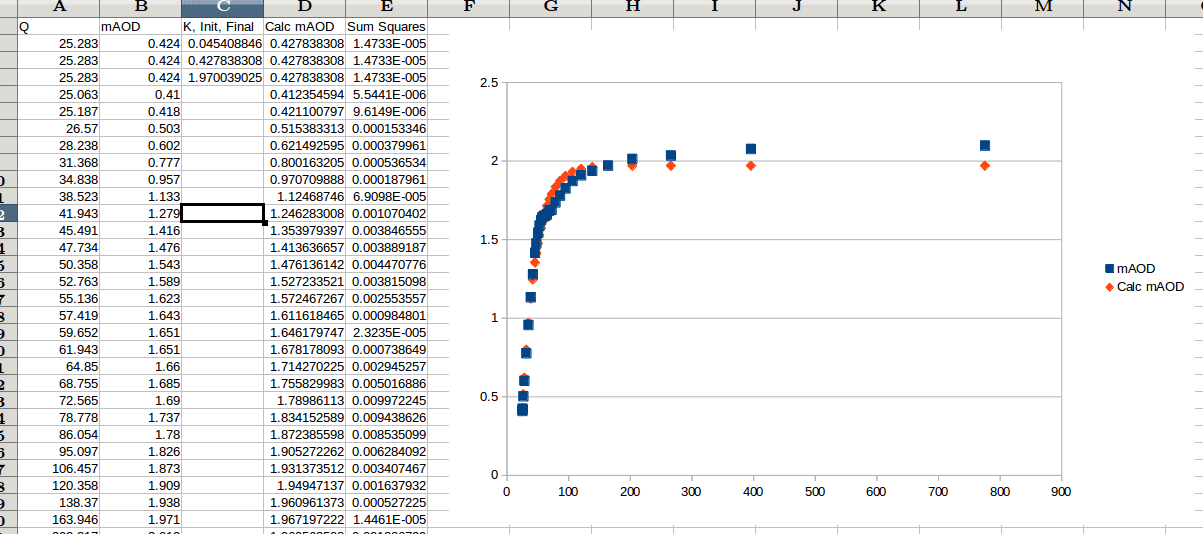

I absolutely love problems like this, so don't feel like I'm over-doing it here. I went ahead and did the analogous calculations in LibreOffice Calc (you have to install a non-linear solver extension to make it work). Here are the results for Test 1: $k=0.0375183810469435$, with a resulting graph of
You can see that from $Q=50$ to $Q=300$, the values diverge a bit from the measured values. You could probably improve this a bit by allowing the solver routine to change the initial and final values. By forcing the model to accept the actual initial and final values, you're sort of "straight-jacketing" the solution.

Here's a solution where I've allowed the Solver Routine to vary the initial and final values. As you can see, it does much better for the $Q\in[50,300]$ range, but does not do nearly as well at predicting the final value.
One more option: you could "glue together" two separate solutions, with the boundary right at the $Q=50$ mark, which is where an expected solution kind of has to change a bit. That could allow a better overall fit; you'd have a piece-wise defined function at that point.
