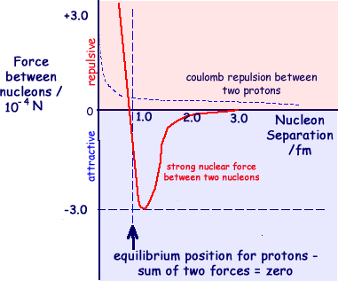

This graph:
Graph of force between nucleons in units of 10^-4 N against nucleon separation in fm, showing a strong attractive well near 1.0 fm, Coulomb repulsion between two protons, and an equilibrium position for protons where the forces sum to zero.
bbbl67 said:
This graph:
That is the force between two nucleons, not between two quarks. The force between two nucleons is modeled with meson exchange, not gluon exchange. The repulsive part of the nucleon-nucleon force is due to vector-meson exchange (like ω) iirc.
Ah, I didn't notice that! I had assumed it was the force within a nucleon, i.e. between quarks.
