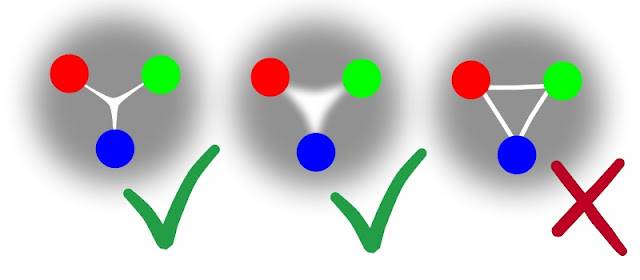

The actual distribution of gluons in a proton differs from many popular textbook artist's illustrations, in that it is more concentrated towards the center of gravity of the proton, in something like a Tinkertoy kind of distribution with a gluonic hub in the middle, rather than, for example, being distributed evenly throughout the proton, or being located mostly on straight flux lines from one valence quark to another.
Sabine Hossenfelder at Backreaction shows what this looks like in an artist's conception form that is more accurate than many common textbook illustrations of the proton-gluon structure within a proton (which the cited paper, unfortunately, does not attempt). The middle illustration is the most accurate of the three.
The mass radius of a proton is smaller than the charge radius of the proton, because the mass of a proton is concentrated in central gluons (on average over time, shown in white).
In contrast, the electromagnetic charge of a proton comes mostly from its electromagnetically charged valence quarks (shown in red, green, and blue to represent their respective QCD color charges). Since, the valence quarks of a proton are concentrated closer to the outer area of a proton (on average over time) than the proton's gluons, the proton's electric charge radius is larger than it gravitational mass radius.

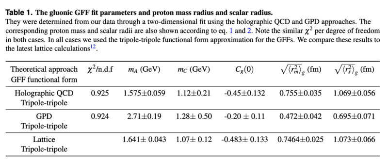

The money chart from the body text is as follows:
By way of comparison, the proton charge radius is 0.842 fm.
The radius we care about and understand as non-nuclear scientists is the mass radius rm in the second to most far right column, and not the scalar radius rs in the furthest right column, which can safely be ignored by a reader at less than the advanced PhD holder level.
A statistical Chi-squared divided by degrees of freedom test (in the first column ) does not significantly prefer the Holographic model over the GPD (for "generalized parton distribution") model used to estimate the proton gravitational mass radius from the experimental data.
But the lattice QCD ab initio calculation of the proton gravitational mass radius, made using only raw physical constants rather than experimental measurements of protons themselves, closely matches a fit to the data using the Holographic model over the GPD model, so the data fit using the Holographic model is probably closer to the truth.
The paper doesn't meaningfully or carefully discuss what it is about the differences between the Holographic model and the GPD model might make the Holographic model a better fit to the Lattice QCD calculations than the GPD model. This lack of explanation is not unusual. Picking the right QCD model to use to fit experimental results into quantities that we care about is more art than science.
