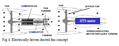

From earlier "[url[/URL], I considered a Bombardier CRJ900, modified with ducted fans, at 12 kWh(41k BTUs) per mile based on its gross range data given a full load of fuel. Perhaps that could be cut that in half for a more efficient, slower, jet aircraft appropriate for this contest, or 6 kWh (21k BTUs )per mile? Distance for the contest is ~2500 miles, with two stops allowed, or ~850 miles per leg, 5100 kWh (17.4 million BTU )per leg.
[PLAIN]http://en.wikipedia.org/wiki/Zinc_air" non rechargeable batteries achieve about 0.5 kWh per kg, giving ~11 metric tons of battery per trip leg. However, power density of metal air batteries is low, at least for commercial models. This 11 m ton pack would provide only 1.1 MW.
Ducted fan concept:

? That's not my sketch. AFRL built a 3MW motor. It's out of the paper in the link I referenced in the other thread.

I'm looking at that ppt, and I have to ask: why would you use an electric motor to power a ducted fan, and not just use a more efficient propeller?

No, I'm saying why would you power a fan, instead of a prop. Larger rotors are more efficient.
At what size aircraft operating at what altitude and for what distance? Why do highly efficient puddle-jumpers side with turboprops while highly efficient medium and long-haul aircraft side with turbofans?
Valid point, but for this competition I fail to see why one would use an electric duct fan.
It is a first across the line, coast-to-coast speed contest. I see the decision (prop or turbofan) depending on the speed/efficiency curve of the chosen aircraft. If the efficiency allows it, go with a fan and get 3-400 knots.
Ducted fan concept:
Can you supply any information about what conditions the HTS motor has to operate in??
Depends of course on the size and performance envelope of the target aircraft. Here's the original thread:
