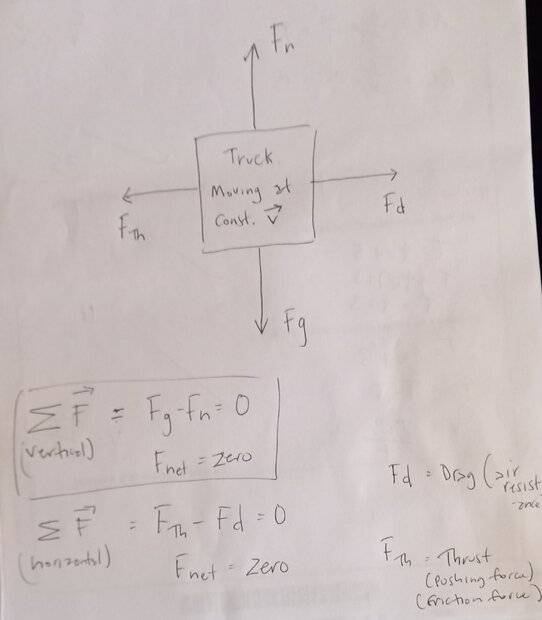

From Khan Academy;
“As truck moves with constant velocity down the road, its acceleration is zero.
Therefore, the net force acting on the box must be
zero.”
Which forces are involved in a truck moving with constant velocity (and therefore no acceleration)?
The gravitational force and the normal force cancel each other out.
But the applied force is greater than the frictional force, hence the truck moving, so how do the overall forces end up balanced resulting in a net zero force?
I’m thinking (wrongly, it seems) that the forces are unbalanced, that there is a net force involved, i.e, the applied force minus the frictional force, which is a non-zero amount.
P.S. There will be two friction forces; the friction between the tyres and the road; and the friction between the air and the truck overall. So the sum will be; applied force minus the two frictional forces, which will still give us a non-zero amount (which is wrong, it seems!)

If the applied force were greater than the frictional force the truck would gain speed. If the applied force were less than the frictional force the truck would slow down and gradually roll to a stop. It does neither, indicating that the frictional force is enough to prevent the applied force from accelerating the truck, the applied force is enough to prevent the frictional force from slowing the truck; the two forces must be equal and opposite.

Let us look more closely at the propulsive force. Say we have a four wheel drive car. The propulsive force is friction from the road on all four tires. That friction acts in the forward direction on the car.
Meanwhile, air resistance is the only force acting on the car in the rearward direction.
Why is friction acting in the forward direction? Because static friction acts to oppose the relative motion that would exist in its absence. With the engine running, the tires would tend to spin rearward against the road. So friction with the road pushes them forward.
The accelerator pedal does not overcome friction between wheels and road. It overcomes air resistance.
Please digest this thoroughly before we open the chapter on "rolling resistance".

paulb203 said:
and after that any unbalanced force is to counter friction (if we want to keep the object moving)
If it is just countering friction, then it is balanced by friction, not unbalanced.
And again, all horizontal forces from a level road are friction, regardless if they propel or brake.
You should start drawing free body diagrams, because your text descriptions are very confused.

Is this FBD anywhere close?
Correction; Fg PLUS Fn. Fth PLUS Fd.
And, I'm thinking now that should be Ff, not Fth.
And as well as Fd there should be another Ff on that side.

paulb203 said:
Thanks, A.T, for your patience, and support.
Is this FBD anywhere close?View attachment 357475
Yes, add the vector arrows above all force symbols, and use + between them.
You can split those 4 general forces into as many parts as you want, depending on the question and information you have. But this is the general force balance for a vehicle at constant velocity.
