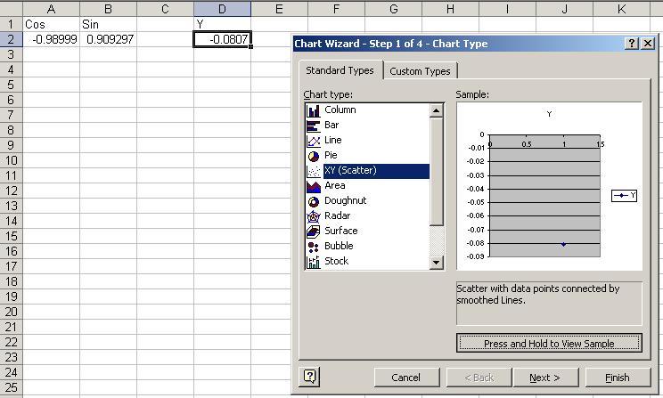

Using a graph format in excel, plot the following function;
Y=2SinӨ + 3CosӨ
for values of Ө between 0 and 90?. From the graph find;
a.the maximum amplitude of the function.
2.A value of Ө which satisfies the equation
2SinӨ + 3CosӨ = 3.5
As evidence, you are required to show what formula you have used to produce the graph.
ok well.. i put 2 in sin, and 3 in cos
and did them added together to give a value, and tryed to make a graph..
i don't get the question, or what I am ment to do, or anything. please could someone help explain or give asmuch help as possible.
Why must you use Excel? Are you permitted to use any graphing software program? If Excel contains trigonometric functions, you might be able to use
something like =2*sin(x)+3*cos(x) for the "formula".
You need to make your first column the theta argument to the function. Put 0 in the first cell (call it A1), and in the second cell A2, put =A1+(90/100). Then click drag the second cell down to row 91, and use Ctrl-D to fill down that equation. That will give you a column for theta that varies from 0 to 90 in 1% increments.
Then the second column should be your Y formula, with the arguments for the sin() and cos() being the cell just to the left. Does that make sense? So you end up with two columns, theta and Y(theta) = 2sin(theta)+3cos(theta). Then use the chart wizard or whatever to make an x-y scatter chart that plots Y(theta), with theta as the horizontal axis, and Y(theta) as the vertical axis.
Does that get you back on track?
BTW, it would be good to double-check the default in Excel to see if the argument to sin() and cos() is assumed to be in degrees, like we are using so far in this thread. If the default is assumed to be radians, then you'll need to include the conversion in your formula for Y(theta).

Excel expects trig arguments in radians. To use degress, convert the degrees to radians with Excel's RADIANS() function ,eg SIN(RADIANS(a1))

Well, I guess I don't understand what you mean or want. I was trying to suggest how to get the proper values for [tex]sin(\theta)[/tex] and [tex]cos(\theta)[/tex] when [tex]\theta[/tex] is expressed in degrees using Excel.
What are you trying to convert to degrees?
To plot the graph in Excel, simply construct the column of theta values (in degrees) as berkeman suggested. Then, construct another column with the expression you posted (Y) using the theta column and the radians conversion function (as I tried to suggest) so that you get the correct values of Y.
Now plot the values of the expression (Y) against the values of theta (in degrees) and read the graph relative to theta (in degrees) to get your answers.
