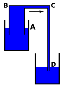

How does SIPHON work? especially with the simple apparatus in transferring liquid from a container to other container. Would you please help me understanding the mechanism behind this. Then principles are used here.. Thanks :)
Wikipedia has a quite detailed description about its working.
http://en.wikipedia.org/wiki/Siphon
If you get confused with something in that, you can post questions about it here :smile:
"In practical siphons, atmospheric pressure pushes the liquid up the tube into the region of reduced pressure at the top of the tube in the same way as a barometer, and indeed the maximum height of a siphon is the same as the height of a barometer, because they operate by the same mechanism. The reduced pressure is caused by liquid falling on the exit side."
how come?
is it necessary not to immerse the end at the lower container the liquid?
why you need the "initial pump", what's that for? what happens if we introduce that initial pump? thanks :)
Do you know http://en.wikipedia.org/wiki/Bernoulli's_principle]Bernoulli's[/PLAIN] Principle?
In a very simple sense, higher fluid velocity results in low pressure than slower moving fluids.
Also, read 'Theory' under siphons in wikipedia. Thats where the main -how-siphon-works- is hidden.
A siphon works because gravity pulling down on the taller column of liquid causes reduced pressure at the top of the siphon (formally, hydrostatic pressure).
As gravity pulls down the fluid, the velocity of the fluid increases, resulting in lower pressure.

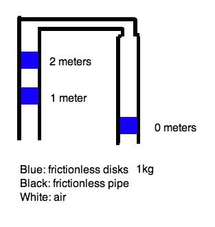

Perhaps we need to look at this from the 'frictionless disks in a u-tube' analogy.
The above image is at Tinitial
Initial air pressures are atmospheric.
What will the image look like at Tfinal?
And what will be the pressures between the disks?
The image is not drawn to scale. The tube above and below the disks extends to 100 meters.
Tube diameter is 1 meter.
ps. I just made this up. It is not an actual homework assignment, that I'm aware of. Recommendations for parametrization will be most humbly accepted. :smile:
pps. Must now go to the river.
