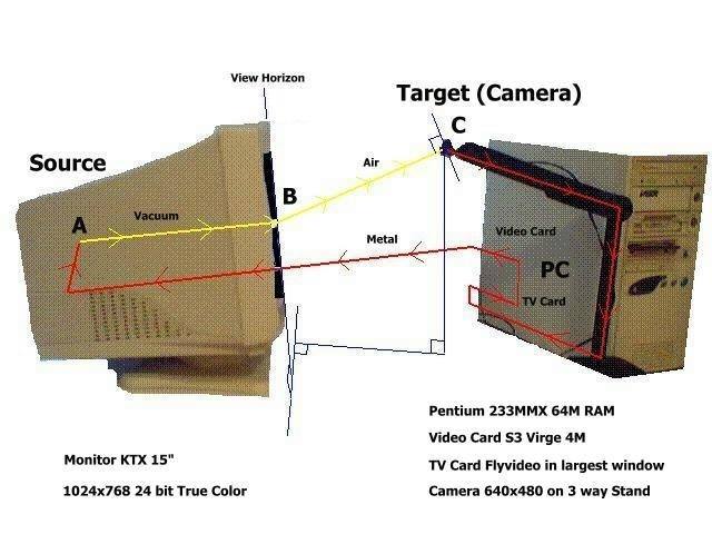

Feedback loops can be very cheap and can be modified easily by things to produce some interesting photos.
I used the attached setup to capture these images over 12 years ago and they are accurate to what you actually see on the screen within the maxed out limits of the hardware/software combination used at the time.

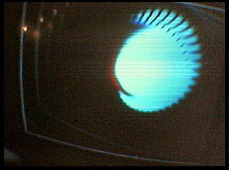

(1) How did I create 2-PerfectOrb?

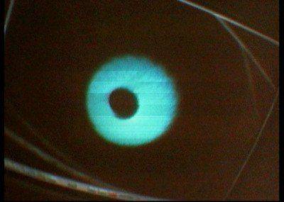

(2) What caused 3-Startled to become startled?

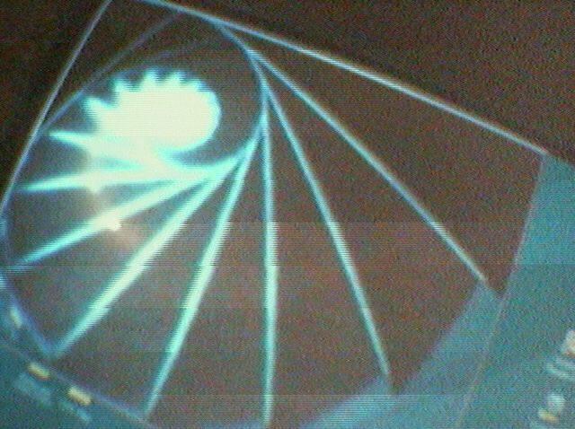

(3) (a) What happened straight after 4-DamnedSpot was captured?
(b) What happened if you did not capture 4-DamnedSpot

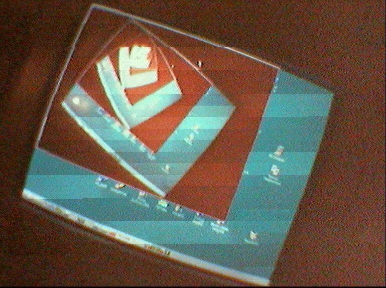

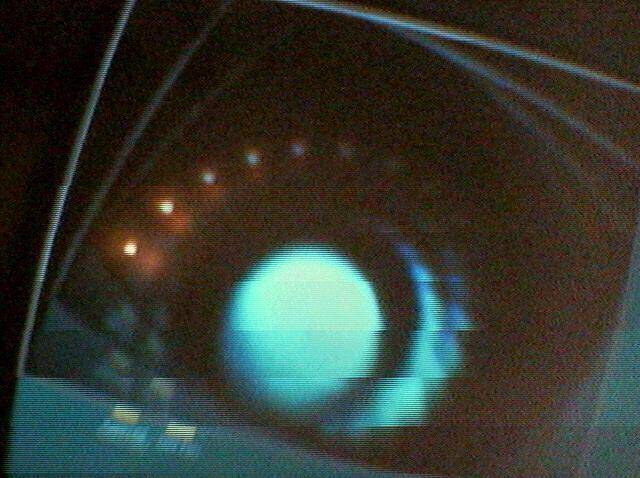

(4) What is the only thing altered between 5-Blue and 6-Orange?

(1) I gradually skewed 1-1-Winiverse until I had 1-2-FernShell. 2-PerfectOrb was not far away.

(2) If you have one you probably won't not be able to put your finger on it.
(3) (a) It's not the same as (b) but it's the same as what you get when you disturb (b).
(3) (b) Einstein predicted it, Zena had one and you too can have one if you turn your loop into a shadow trap.
(4) You are either too close and too far or too left and too right or too up and too down.

The loops hardware/software is constant, each image has one discrete distance, three discrete angles and any other optical interference is constant/fixed/, for anybody who wants to try to work out the maths behind it.

I had a *really* hard time replicating this with my (digital) USB camera, IIRC all I needed to do in the analog age was to play with the 'synch' dial on the monitor and the NTSC signal protocol did the rest..
This morning I was able to get something by tweaking the camera frame rate relative to the monitor refresh rate, but it wasn't much more than a vague approximation to a strobe light.

I think the ratio of the lag in the old PC hardware has to be similar to capture images like these, that's why I posted the setup specs. I have tried to do similar things on newer hardware but I couldn't replicate the images because the resolution, capture speed, monitor size, tv/video card lag was different and the on screen window had an ugly thick skin around it.
I'll let you know how the (3) images were generated after you've had a go. (3) (b) is an amazing sight to behold so, if you can find any, you can post astronomical images of (3) (b) on this thread as well. Cheers.
Just put your finger on the edge of 2 PerfectOrb on the screen and hold it there to distort the image as shown.
