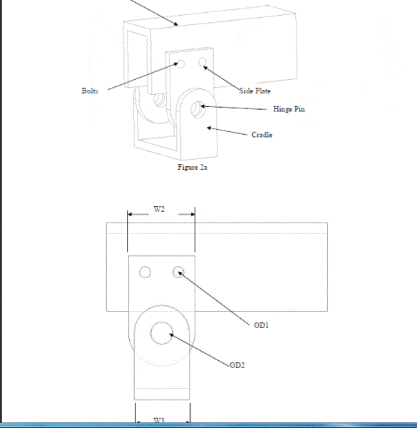

is it possible to calculate the width and thickness of a plate that is helping to support a beam when you have values for shear and bearing stress, a diameter of to bolts and the load it carries.
i have tried using bearing stress = load/diameter*t and then rearanging for t but the answer is wrong.
May2-11, 02:20 PM   #7
Bearing stress is one of many modes of failure. Do you have a sketch of your bolting arrangement?
May2-11, 02:36 PM   #8
yes i have attached it to this post
May2-11, 07:44 PM   #9
You should check failure in both the hinge pin and bolts. In addition to the bearing stress consider:
2) Tensile failure = 2 X La X plate thickness
where La is the distance from the edge of the hole to the edge of the plate.
3) Pin push block out = 2 X d X plate thickness, where d = distance from hole edge to part edge.
