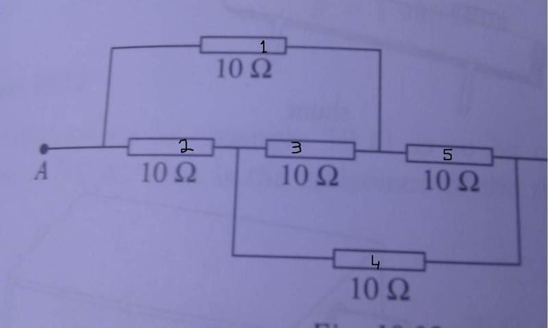

b]1. The problem statement, all variables and given/known data[/b]
Find the total resistance of this complex combination of resistors.
Click image for larger version
2. Relevant equations
R(total)= (Rr)/(R+r)
3. The attempt at a solution
resistance of r(2) and r(3) = 20Ω
resistance of the combination of r(1) and the resultant 20 Ω(ie r(2) and r(3) ) = 20/3
resistance of r(3) and r(5) = 20Ω
resistance of te combination of r(4) and the resultant 20 (ie r(3) and r(5) ) = 20/3
I can't deduce and answer from the above (correct) results.
Need urgent Help !!

Stick either a voltage source or a current source at terminals AB. If it's a current source, find the voltage drop across AB. If it's a voltage source, find the current it's driving into the circuit. Either way the overall resistance of the circuit will be the ratio of the voltage to the current that the source delivers.

http://en.wikipedia.org/wiki/Y-%CE%94_transform
This is how you gona solve it.

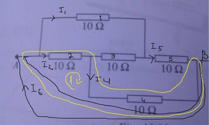

1,2 and 3 are in triangle, same 3,4,5, change one combination with triangle-star transform and its solved.
My result is 10 ohm.
With kirchhoff.
Lets make I6=10 (you can give it any value you want)
Now, when the current is at A it will be divided by 2, because R1=R2, I3=0 from KCL.
So I1=5, I2=5, i4=5, i5=5.
Now, what you gona do its to KVL in loop 1 (yellow) to find Uab.
After finding Uab, Rab=Uab/I6.
http://www.physicsforums.com/attachm...1&d=1331595516

This circuit can be analyzed by the use of symmetry.
An equivalent circuit to this is on with A at one corner of a square, and B at the opposite corner.
Label the other two corners C & D respectively, the corners being labeled: A, C, B, and D in a clockwise sense.
Resistor 1 connects corners A and C.
Resistor 2 connects corners A and D.
Resistor 5 connects corners C and B.
Resistor 4 connects corners D and B.
Resistor 3 connects corners D and C.
