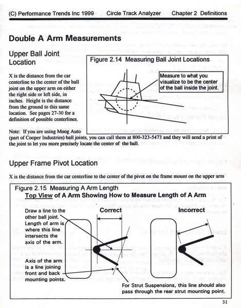

Hey mike!
Finishing up my race car build, found a friend with chassis software, now wondering where to measure my upper control arm pivot points so i can determine roll center. The upper control arms on my car are angled so at what point do I pick to plug into my software? Dead center?
  • #546
welcome and sounds like a good plan. On all the chassis software i use, i have to measure the height and location from center line of the top outer pivot point and top inner pivot point and the software calculates the angle. The better and more accurate you measure, the better. I had to make stop blocks to jam under the lower A-arm to maintain exact height and slipped off the front tires on occasion when running wide tires and big wheel offsets masking the outer pivot point. Eventaully I borrowed a portable cmm arm.
  • #547
Perhaps my question wasn't clear enough, or maybe because I haven't I looked at the software I am confused, but what I am having trouble understanding is where on the pivot do I pick the point to put in. The arm is angled like I drew up in paint.
That is in a two dimensional plane...
  • #548
on circle rack analyzer use attached..i use suspension analyzer which requires 3D input

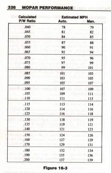

  • #559
Thank you so much for the picture, it helped immensely.
Here is a theoretical question for you. On a small 1/4 mile track with a 7-10 degrees of banking, which car would be more successful.
Car A) 52% Left side weight, 2300 pounds total
Car B) 55% Left side weight, 2450 pounds total
Assuming all other things similar (rc/cross/ect), fwd chassis, stock everything
  • #560
lighter is faster
thank you...in my opinion, lighter is faster and what you said. this is a bone stock class...which means power to weight ratio is everything...if bot hcrs have same engine..i.e .power out put...go with the light one.
  • #561
light is right
We all know the saying “ opinions are like A------s, every one has one”
Let us look at the above post and put some numbers to it.
Given the race car has a ultra stock restriction..we assume the tires are hard, tall and narrow.
If we assume the engine is stock as well and may put out maximum of 150 horsepower
we need to look at the power to weight ratio.
150 / 2300 = .065
150/2450 = .061
looking at the attached table we see that the lighter car will make 3 mph more speed over 1/4 mile.
Lets look at the weight transferred ( see post 19 on page 2) -
2300 x .35 = 805 pounds transferred to the front and right side
2450 x .35 = 857 pounds transferred to the front and right side
remember that right front tire has a pretty small footprint to begin with and we don’t need an
additional 30 to 40 pounds overloading it. Don’t forget that additional left rear weight is going right over to the right front going into a turn.
The McPherson strut situation has bad camber build to begin with.
To summarize, for the same horsepower, light is faster, light is easier on the spec tires, light means slightly more acceleration off the turns.

although all your methods was on the mark,but since i am learner,i do have difficulty in understanding this second point.
2. draw the ground line ,vehicle center line and center of the left and right tire contact patches. Determine where the outer lower control arm ball joints (BJ) are located by bolting the upper and lower control arms to the spindle and bolting the spindle on the wheel to be used...some round track cars have different wheel offsets so be careful. mark these BJ centers on the drawing.
my question is..how will we determine the outer lower ball joints..?
i want to design a suspensiom system,and i wann know where to start from?
and how will we locate the pivot joints and how will we determine the lenth and angle of the arm..?
I am using double wishbone
  • #566
starting chassis from scratch
Welcome and great questions...
Please note on Page on page 6 of this post..shows typical ball joint. To do a good job you can contact the manufacturers (Moog) being one), and have them send you diagram of exact pivot point. Another alternative is to find and old ball joint of same type you intend to use and cut it to determine the center of the ball stud.
