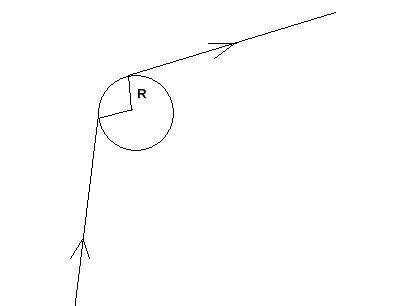

If a car actually changed direction in zero time, the G force would be infinite because the corner where 2 straight lines meet has zero radius.
You need to get a non-zero radius at the corner. Then you have a piece of a circle and the centripetal G-force is easy to calculate from the standard formula.

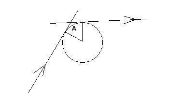

I understand your diagram, despite the absence of tabs. Have a look at the pic I've attached. Assume your car is traveling on a circular arc while turning. As soon as you have the radius, the answer is easy.

Earlier you suggested that the change takes place in a unit of distance.
Have a look at the pic. You can choose your circle so the section of arc I've labelled 'A' has length 1. The paths intersect tangentially with the circle.
You're designing the road, you can decide the tightness of the corner.
