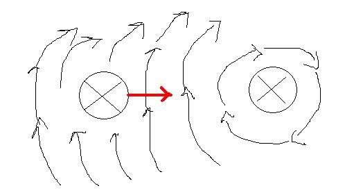

So by my understanding, that's what you mean, right?
If so, I understand what you're saying up to actually using the RHR#2 as your last instruction. I can't see how that makes sense. How do you know where the red arrow points? The thumb is the force, right? How can I get the magnetic field to be circular? (Besides, the RHR#1 and #2 seem to be different depending on which textbook) :/

So, from your diagram the wire with the red arrow creates a magnetic field that points down. The opposite wire sees a magnetic field pointing down, and because its current goes into the page, the right hand rule will show that a force causes the wire to go to left.
Now repeat the process for the opposite wire creating a magnetic field that the wire with the red arrow sees. It will see a magnetic field pointing field pointing up, and so you take your hand and point it in the direction of the current (into the page) and curl your fingers towards the magnetic field (up). Your thumb will point in the right direction, and so the force goes to the right.
Both forces point towards the opposite wire, which shows that the wires are attracted to each other.

No, the thumb is the direction of "I" the "conventional current" (opposite the electron flow).
Looking at the left wire which is in the magnetic field pointing up (just forget the "clockwise" designation--where the wire is, the B-field is pointing UP).
fingers in the direction of the B-field, thumb in the direction of the current, Palm is Pointing in the direction of force on the wire. Try it.
Thanks :) I've worked it out.
