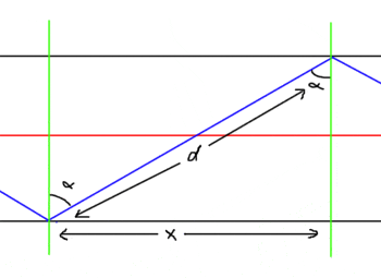

Yes, light would travel faster through a straight fiber optic than it would in a bent one. If the fiber is bent, light will refract as it hits the sides of the fiber, therefore it will take more time to travel the same horizontal distance:
https://www.physicsforums.com/attachment.php?attachmentid=813
The red line represents a ray of light that does not refract, whereas the blue line is a ray of light that does refract off the sides of the fiber.

Yes, light would travel faster through a straight fiber optic than it would in a bent one. If the fiber is bent, light will refract as it hits the sides of the fiber, therefore it will take more time to travel the same horizontal distance.
Fiber optics works on total internal reflection - so it shouldn't matter if the cable is coiled.

Yes, and? Do you not agree with what I said?
I am with Russ on this one. I do not think propagation time in a fiber optic depends on the bends in the cable. Most fiber optics have a minimum allowed radius of curvature, you cannot coil them into an arbitrarily small radius and maintain the signal. It would not surprise me if the coiled fiber had higher losses then the straight one, but I do not think it would change the propagation time,Signifinatly... (gotta throw that qualifier in there!)
Well now, there's a large difference between changing the time and changing it "significantly". I still believe the propagation time would change. In a straight fiber, light is free to take the shortest possible path - a straight line, which would have the same length as the length of the fiber. However, with a bent fiber of the same length, this is not possible. For the light to go through the fiber while traversing a distance of L, it would have to go directly through the center (of the cross section) of the fiber, and do so throughout the whole journey. Obviously this cannot happen, as the light is bound to hit the boundaries of the fiber and reflect. By doing so it is no longer going through the center and the distance it has to pass grows. I think the difference in the propagation times would depend on the radius of the fiber, among other factors. The thinner the fiber, the less noticeable the difference would be.

Chen, its a minor quibble: the light does go more or less straight down the cable, but obviously no cable is going to be perfectly straight, so there will be a lot of bouncing off the walls, especially since the cable is pretty thin. Yeah, the word "significant" is vague, so how about this: the diameter of the cable is so thin compared to the minimum radius at which you can bend the cable that any change in transmission time will be negligible.
But because the fiber already depends on total internal reflection, the path length is greater than the linear distance of the cable - the light doesn't go straight through.
But if the fiber was originally straight there would be the possibility that the light would go straight through. That's the point.
