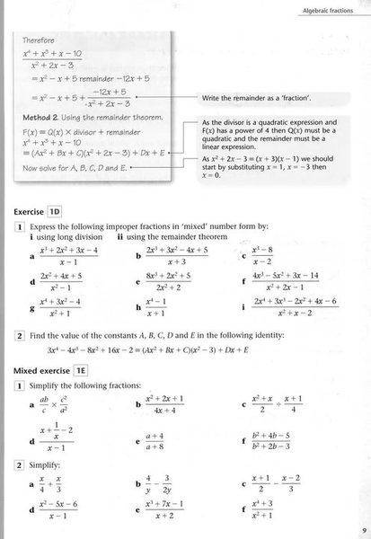

Using the remainder theorem solve
[tex]\frac{8x^{3} + 2x^{2} + 5}{2x^{2}+2}[/tex]
The remainder theorem:
[tex]F(x) \equiv Q(x) \times divisor + remainder[/tex]
[tex]8x^{3} + 2x^{2} + 5 \equiv (Ax+B)(2x^{2}+2) + C[/tex]
I can do it for linear divisors but i don't think I've set this out correctly for a quadratic divisor
Any suggestions. Thanks

The remainer term should be Cx + D since the divisor is quadratic. Multiply everything on the right side out and compare them to the coefficients of the left hand side. For example, the only cubic term on the right will be Ax^3 so A must equal 8.

Question Exercise 1D question 1 (e)
not sure why the remainder must be linear Cx + D. Same, with the example in the box at the top righ tof the page. What are the rules??
Thanks. Tom
Hi Tom! :smile:
The rule is pretty much the same as for remainders in ordinary arithmetic …
The remainder must be smaller than the divisor!
So if you're dividing by 17 in ordinary arithmetic, the remainder can't be higher than 16.
And if you're dividing by x² + ax + b in polynomial fractions, the remainder must be less than x², so it must be linear.
By coincidence, in the case you're trying to solve, the Q(x) must be linear also, because the largest power in Q(x) will always be the largest power in the divided minus the largest power in the divisor … in this case, 3 minus 2

There's no need for complex numbers here. You guys are confusing two related theorems because of the name that book uses. The remainder theorem says that if f(x) = q(x)*(x-a) + r(x) then f(a) = r(a). Notice the linear term is needed since it goes to zero when x = a. The question here has nothing to do with that theorem, but with polynomial division.
8x^3 + 2x^2 + 5 = (Ax+B)*(2x^2+2) + Cx + D.
(Ax+B) must be linear since the highest power on the left is a cubic, and the remainder must be linear since otherwise 2x^2+2 would still divide into it.
Expand out the right hand side.
8x^3 + 2x^2 + 5 = Ax^3 + 2Bx^2 + 2Ax + 2B + Cx + D
Regroup all the terms with similar powers of x.
8x^3 + 2x^2 + 5 = 2Ax^3 + 2Bx^2 + (2A+C)x + D + 2B
Then set all the coefficients on right equal to the corresponding coefficients on the left.
2A = 8
2B = 2
2A+C = 0
D + 2B= 5
You can solve this from here, right?

Sorry, Vid, but you're missing the point … Tom's book says:
As x² +2x - 3 = (x + 3)(x - 1) we should start by substituting x = 1, x = -3 then x = 0.
That is using the genuine remainder theorem.
And since it's his book's method, he does need to know how to do it. :smile:
The book isn't using the remainder theorem there, it's just outlining an alternative method for solving for A,B,C,D, and E. Just like when we all learned partial fractions in Calc. 2, we learned two ways to solve for the constants. We could either set up a system of linear equations (my post) or sub in values of x (the book's method.) Either way, it still has nothing to do with the actual remainder theorem.
