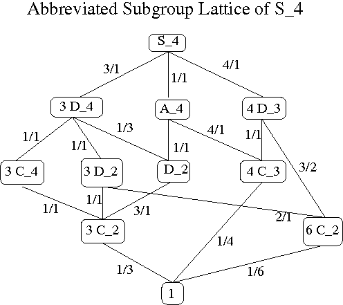

  • labeling each vertex with
    • the number of subgroups in the class
    • a familiar name for the isomorphism type of the groups in the class
  • draw an edge from between class C1 to the smaller class C2, labeled m/n where
    • each subgroup in C1 contains m members of C2
    • each subgroup in C2 is contained in n members of C1
    where only the minimal edges are drawn in a fairly obvious sense, to make something which looks like a decorated Hasse diagram (for a poset).
The information required is contained in a useful construct little known outside group theory, the so-called table of marks popularized in one of the first group theory textbooks, the one by Burnside, which is still useful.
(Some of you may know that in the first edition, Burnside famously commented in the introduction that his book ignored the then new methods of Frobenius, now taught to math and physics students as the representation theory of finite groups, because these methods hadn't yet been used to prove anything the older methods could not accomplish. Soon after, Burnside himself used the methods of Frobenius to obtain an elegant solution of a long open problem which he had tried and failed to solve for many years! The second edition of his textbook acknowledged his newfound appreciation for representation theory and included an introduction to the representation theory of finite groups. This is a powerful and elegant theory with few prerequisites; a readable modern introduction is James and Liebeck, Representations and Characters of Groups. A fine followup book would be Sturmfels, Algorithms in Invariant Theory, a very readable introduction to the invariant theory of finite groups, another very elegant and powerful theory. These two theories are like two gloves--- if you only wear one you will probably look a bit...eccentric. The corresponding theories for Lie groups are of course also powerful but much more involved; they work best for the reflection groups studied by the great Canadian geometer, H. S. M. Coxeter.)
Here's how to carry out this procedure for [itex]S_4[/itex] using GAP: fire up GAP and load the small groups library, then:
Code:
G := SymmetricGroup(4);
pts := MovedPoints(G);
# Lattice of subgroups
tom := TableOfMarks(G);
Display(tom, rec( form := "supergroups"));
Display(tom, rec( form := "subgroups"));
num := Length(List(ClassTypesTom(tom)));
Notice that the output falls into blocks which correspond to natural "layers" in the abbreviated subgroup lattice. In more complicated examples, this might not happen automatically (or at all), but GAP provides a way to reorder rows and columns, which can help so "see" the shape of the graph.
To try to quickly identify the conjugacy classes up to isomorphism of groups, it's best to try the following commands line by line (referring to the table of marks) since GAP doesn't handle errors very cleanly, but in a very small group you can do it all at once:
Code:
List([1..num],j->[j,IsTransitive(RepresentativeTom(tom,j),[1..deg])]);
List([1..num],j->[j,IdSmallGroup(RepresentativeTom(tom,j))]);
Anyway, see if you can figure out how to get from the table of marks in the form output if you enter the command suggested above into a GAP session to the abbreviated subgroup graph in the figure. In this simple example, only one edge has a nontrivial labeling, the one from the vertex C labeled 4 D_3 down to the vertec C' labeled 6 C_2, which I labeled 3/2, meaning each subgroup in C includes 3 subgroups in C', and each subgroup in C' is included in 2 subgroups in C. Notice that 4*3 = 12 = 6*2.
If you're lazy, there is a separate package you can install which draws the non-abbreviated subgroup lattice, which is only useful for very small groups, but some of you may wish to find it and try it. It's called XGAP.
For those interested in Kleinian geometry, GAP also enables one to quickly draw a sublattice of the full subgroup lattice, the lattice of stabilizers, which is dual to the lattice of fixsets (defined just as in classical Galois theory). The abbreviated stabilizer lattice is very interesting for many reasons:
  • identifies the "geometric elements" in the appropriate "finite geometry" defined by our permutation group, e.g. points, lines for a finite projective plane,
  • tells how these objects are related to one another (e.g. so many points lie in each line),
  • gives more information than Polya counting, by passing to a suitable wreath product and taking the abbreviated subgroup lattice of the new permutation group,
  • problems in elementary combinatorics can be formulated in terms of structors (aka combinatorial species--- a structor a certain kind of functor) and then this viewpoint can be seen as a reformulation of combinatorics in terms of group actions,
  • gives a kind of common generalization of classical Galois theory and the theory of Boltzmann entropy (log of multinomial coefficient; closely related to Shannon's information theory); the fixsets up to conjugacy and inclusion relations captured by the table of marks are analogous to entropies and conditional entropies.
GAP also handles groups defined by means of generators and relations, and the above procedure works for them too, you simply first use GAP to obtain a permutation representation of your group. And GAP can work with matrix Lie groups fairly readily, which is particularly useful for studying reflection groups, e.g. the group E8 is rather famous these days due to Garrett Lisi's proposed theory. (Garrett is a sometime PF poster in the "Beyond the Standard Model" subforum, incidently!) GAP also recognizes other useful ways of defining groups, but these are probably of interest mainly to specialists.
Figure: Abbreviated subgroup lattice of S4 (symmetric group on four elements)
