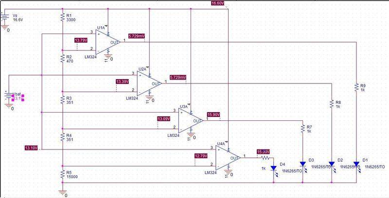

so, attached here is the circuit i simulated.
Vbat acts as the input to the four stages of the voltage level indicator.
what will happen to the LM324 if for some reason the terminal voltage being measured
exceeds 16.6V which is the supply voltage of the op amp?
let's say a voltage spike of up to 30V?

The absolute max differential input voltage is specified as 32 volts so you should be OK up to this value, although the output will obviously limit.
Yes at 30 V you should be okay, however if your voltage spike should go up to 35 or 40 V, then you may destroy the device. To prevent that you could add a high value resistor in series with each input you want to protect. The opamp input impedance is high enough that the resistor will have little effect in normal operation yet will protect the opamp in the event of a voltage spike.
your posts have been a great help!
