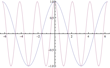

Here's a plot of cos x and cos 3x. Can you see the answer?

The period of the signal can be no less than the period of the lowest-frequency component. In this problem, that component corresponds to the cos t term, which goes through one cycle when n=16. The cos 3t term will go through exactly 3 complete cycles in the same period — this is the insight I was hoping you'd grasp from the plot — so n=16 is the period of their sum. Hopefully, you see the general pattern. If the faster-oscillating terms have frequencies that are integral multiples of the lowest frequency, the period of the lowest-frequency component is the period of the complete signal.
