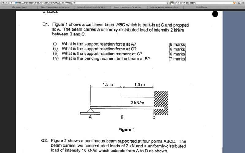

I have been trying to solve this question using the superposition method, but cannot seem to get the correct answer. Can anyone help?
Question & formulae are attached.
Cheers, G
here are the files
the answers are;
Ra=0.33 kN
Rc=2.67 kN
Mc=-1.27 kN
Mb=0.49 kN

Seems a simple enough propped cantilever.
Do you realize you have to add some ficticious forces (loads) to complete this by superposition? If you do this all the necessary parts are tabulated in your second picture.
You need to show us some of your own working (even if wrong) before we can help further.
To solve this, i would state that the deflection of the beam at A equals 0.
I am just unsure how to calculate the deflection due to the distributed load using the table. This is because the table doesn't offer any deflection equations for beams that have distributed loads on only parts of the beam rather than all of it.
If the distributed load was on the first half of the beam i would have no difficulty solving it. It's just that the point i am trying to calculate deflection for (i.e. point A) does not lie within the distributed load.
Any advice?

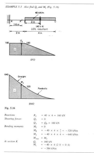

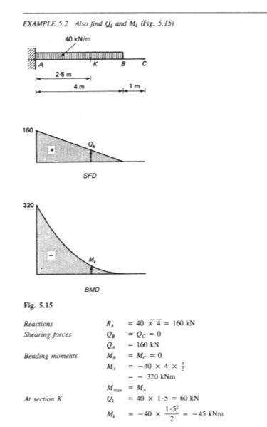

It is difficult to know what advice to offer since I don't know what beam methods you have covered. You would not usually do this by superposition alone.
Perhaps these examples will help
