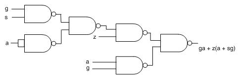

I'm trying to convert this expression: ga + za + sgz
using just 2-input nand gates...more specifically the 7400 ic chip.
I'm trying to use as little NAND gates as possible. I've got (ga + za) down to 5 NAND gates currently...I can only use 8 total NANDS for this.

I can do that expression with six 2-input NANDs. I don't see how to show you how without showing the solution. Is this a homework problem to hand in?

OK. Here's my circuit. One NAND is used as an inverter.

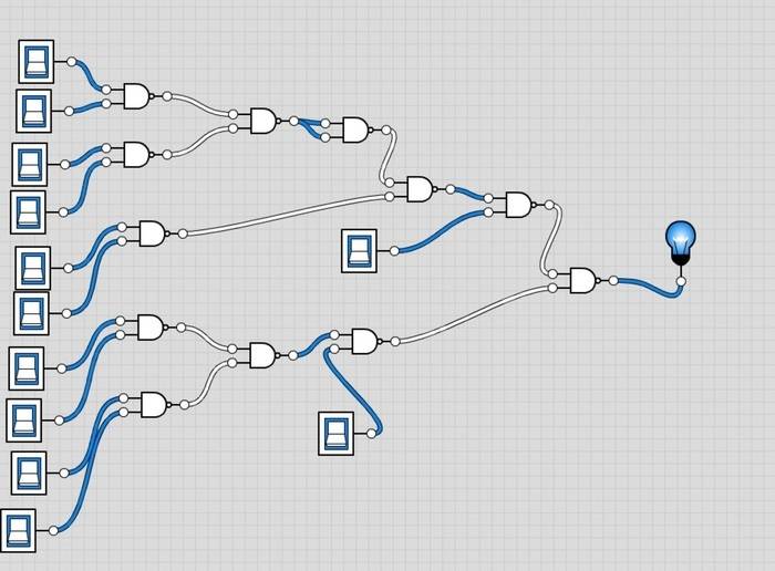

original form: ##ab \bar ce## + ##b \bar cde## + ##cde## + ##abc## + ##acd \bar e##
condensed form: ##b \bar c(ae + de)## + ##c(de + ab + ad \bar e)##
partial circuit diagram using NANDS ##c(de + ab + ad \bar e)##:
I made that portion with 7 NANDS...I still have to finish the ##b \bar c(ae + de)## portion of the diagram...still have 5 NANDS left.

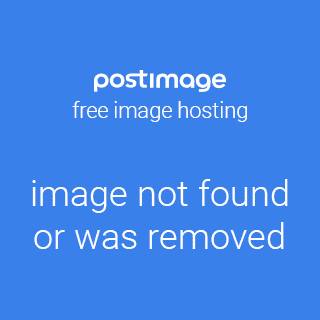

i figured it out thanks to oxygen's logic...I checked all 32 combinations for all the letters related to the problem...and all of the outputs came out correct.
final condensed form: c(de + da + ab) + b(ae + de)
heres my diagram:
rjs123 said:
i figured it out
Good.
http://s16.postimage.org/mb1ot390j/tit.jpg
I think you unnecessarily duplicated D NAND E
when you could have used the output twice?
