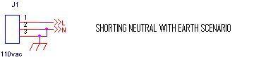

- Some participants note that neutral and earth are typically connected at the main power panel, which may influence the outcome of shorting them.
- One participant suggests that shorting neutral to earth may not cause issues if the wiring is correct and the power source is grounded, but acknowledges that this does not apply to all situations.
- Concerns are raised about the potential for neutral to become live if there is a break in the neutral connection, which could lead to dangerous conditions.
- Another participant describes how improper wiring, such as swapping neutral and active wires, can create hazards, particularly if the neutral is mistakenly connected to ground.
- A participant explains the concept of a "Multiply Earthed Neutral" (MEN) system, detailing how it operates and the implications of connecting neutral to earth in such systems.

philrainey said:there is a concern it that if there is a bad connection (Break) in the Neutral somewhere the Neutral would become live creating a short circuit (hopefully blowing the fuse )
How do you figure? Where did you come up with this misinformation?

Earth leakage detection, AKA residual current detection, compares the current flowing in the neutral and active wires. It does that by winding them together on a magnetic core. Their currents should be equal and opposite so there should be no magnetic field in the core. If a magnetic field is detected then the circuit is quickly broken automatically.
Any current that returns through the Earth rather than the neutral will trip the system because the neutral and active currents are no longer equal and opposite. That will happen if you connect an Earth to a neutral on a circuit that is drawing current since part of that current will flow through the Earth wire. If no current is being drawn while the Earth to neutral connection is made it will not trip.
For a street with several single phase customers, each will have their own grounded Earth and a common neutral for the street. But their active will be taken alternately from the three phases available. That will tend to balance the load on the phases in the street. So your two neighbours will have a different active phase. Your neighbours neutral, active and Earth are all different to yours so they cannot be paralleled.

Averagesupernova said:How do you figure? Where did you come up with this misinformation?
Yeah you are right I'm wrong , for the case of the appliance to become live there would have to be both a bad Earth and Neutral and it wouldn't blow any fuse.

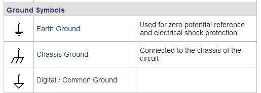

from http://www.rapidtables.com/electric/electrical_symbols.htm#ground%20symbols
- 23,876
- 11,345
Yes, but I believe in Britishese, the term is "earth".Evo said:Stop me if I am wrong here. But in English the term is GROUND not Earth. I remember years ago my Toyota car manual said to EARTH one end of a connection. They meant GROUND one end.
- 24,114
- 3,277
Yes, that was the case.Baluncore said:What Toyota really meant was “connect it to the chassis”.
Thanks!dlgoff said:Ground is ground. It's a question of "what" ground. Here are the symbols:
