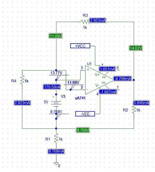

This is the snap shot i took from Pspice simulation
I have a doubt here
***why is voltage at non inverting terminal is 13.77V even though i connected 5V dc source to it and why the voltages at inverting and non inverting terminals are not almost same ( which we consider while solving opamp circuits)
thank you .
Normally, when someone says they connected a 5v source to a point they mean they connected a voltage source between that point and ground. But in the schematic, it shows the 5v source connected between that (strange) 8.769V point and the non-inverting input. So naturally it is going to make the non-inverting input 8.769 + 5.00 = 13.769V.

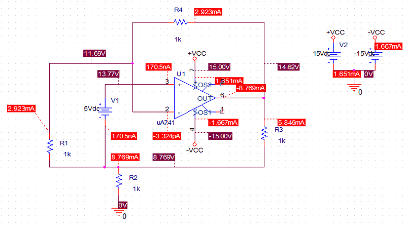

I have exactly resimulated your circuit.
I've also opened "eval.lib" and found the macromodel

That thing has two transistor in it and hence its gain is not infinity. Rather in the datasheet it mentions 200 V/mV (min 50 or 75 V/mV)
Anyway, 200x1000x(13.77-11.69) = 416000 ! looks like the thing got saturated and its placing +VCC - some Vce drops at the output. Now do a consistency check and you'll find out all nodes/currents has correct values to make it 13.77V and 11.69V at the input.

Also this is the output file of the simulation
Look how most of the solution voltages inside opamp are close to 15V

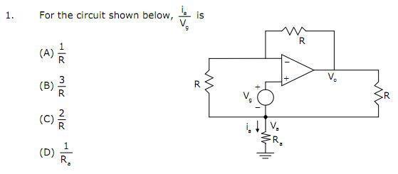

Is this a schematic you thought up? What is it supposed to do or show?
I was trying to solve this
i got ans as B
in the simulation we get Ia/Vg=1.75e-3
but according to schematic we get 3/R=3e-3
not matching !
why is this ?

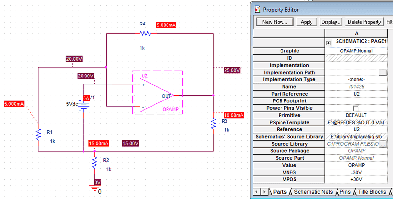

got it :) and Is there a way in Pspice to simulate using all ideal Opamp conditions so that we get almost same voltage at inverting and non-inverting input terminals on simulation ?
Yes. You can get an ideal opamp by selecting "OPAMP" from "ANALOG" library. Its has a gain of 1E6 with default voltage limits of 15V.
Code:
**** INCLUDING test-SCHEMATIC2.net ****
* source TEST
V_V1         N00089 N00241 5Vdc
R_R1         N00241 N00379  1k
R_R2         0 N00241  1k
R_R3         N00517 N00241  1k
R_R4         N00517 N00379  1k
E_U2         N00517 0 VALUE {LIMIT(V(N00089,N00379)*1E6,-15V,+15V)}
When you first simulate it the voltage saturate.
Notice the voltage difference b/w positive and negative pins.
Change the opamp settings from properties to make voltage limit 30V.
Then you get the correct answer.
Yes your answer is correct. Ia/Vg = 15mA/5V = 3mS = 3/1kOhm = 3/R

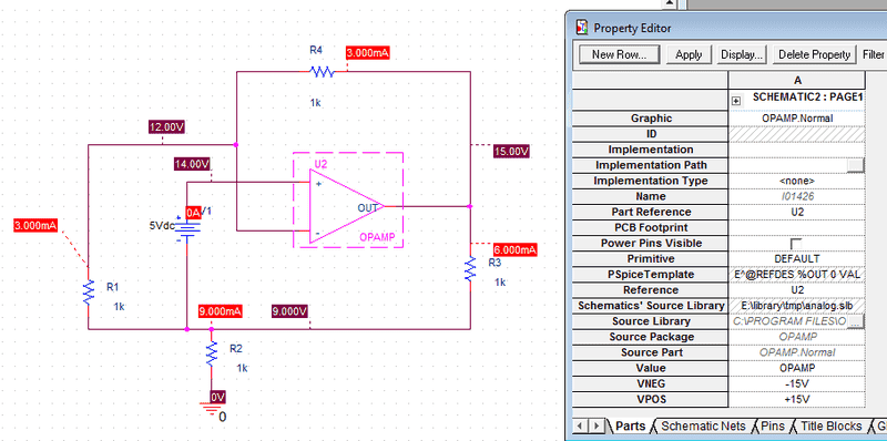

https://www.physicsforums.com/attachment.php?attachmentid=47783&stc=1&d=1338382293
still not getting
i think i should use newer version of pspice
I'm using V9.1
still not getting what?
I use v9.2
Why you use the simulation instead of proper analysis? For example by using nodal analysis ?
i got ans as B
I agree with (B).
For Sanity Check.
Basic rule for opamps: It is the duty of the circuit designer to surround the opamp with a circuit that allows it to balance its inputs.
have you worked that circuit in your head?
Q: In order for the opamp to balance its inputs, what must it be able to do? How can it drive them to same voltage?
A: It must be able to push five milliamps down through R4. That'll make inverting and noninverting inputs equal at 5 volts > than the node at top of R1
Which means it must raise its output pin to ten volts> whatever voltage is at top of R1, in order to push those same five milliamps through R3 as well.
Which in turn means it will also push ten milliamps down through R2.
Which means those fifteen milliamps will need to flow down through R1.
Which means voltage at top of R1 will be fifteen ,
at top of R4 twenty volts, that's inverting input and note noninverting would be same,,,
and at output pin twenty-five volts.
That's hard for the opamp to do with just a fifteen volt supply.
So it goes as far as it can and gives up.
EDIT Which i think Kholdstare figured out in post #7.
