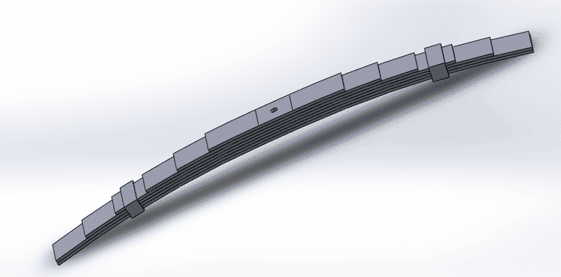

I have to model friction in ansys workbench for the geometry i attached - static structural analysis.
I basically have to define the contacts...
I don't know what contact settings to keep... so can someone suggest me what contact settings to keep?
Loads are applied at the two ends
The support is in the center...
So there is friction in the beams - downwards force of 500N is applied on both sides.
It will be great if someone can suggest me what contact settings to keep in ansys workbench
i mean "contact" settings under "connections" sections in the model of static structural analysis. what effect does the pinball region have on the analysis?
It is all in the help manual. If you are using ANSYS traditional then the command is PINB. In Workbench, it is the same command.

I am not sure how to use Workbench all that well. I am a Traditional user. Your geometry is not all the complex, I think you would do better using Traditional with a 2D model and invoking the contacts via the EINTF command using offset nodes. Also, I am not sure of what you are solving for i.e. stress and/or deflection or something else.

Basically i have not used friction before, all i that is going to happen in this analysis is that, there is friction between all these 'leaves'.
Applying the forces causes deflection of leaves, and since these leaves are joined/constrained by geometry... all these will slide together forming a rigid structure.
If the leaves deform as a rigid structure then just leave out the friction and model it a s a rigid structure.
The manual can easily be searched with the command name PINB. It took me about 3 seconds to find it.
