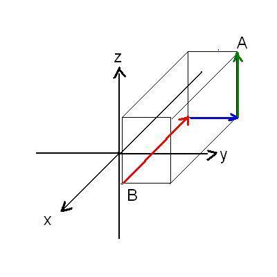

Calculate V(ab) if E = (-5 y / x^3) ax + (5/x) ay + 4 az V/m.
A(-8,3,2) and B(5,2,3).
Vab=-∫Edl
So I tried
V=-[∫(-5y/x^3)dx {from 5 to -8}+ ∫(5x)dy {from 2 to 3} + ∫4dz {from 3 to 2}]
The problem is that the limits are wrong. What should I do?
Should it be the distance and not the literal point on the plane? like the first one, should it be 0 to 13, the second one 0 to 1, the third one 0 to 1?
and what do I do with the remaining variables after the integration. For ex, in the first one I would have a y and on the second one a x

Potential exist if the curl of the electric field is zero. Have you heard about that?
If not, check if you copied the formulas for E correctly, or any path is given in the problem. If you were supposed to integral for the path you used, note that when determining the integral for a line segment, the initial and final values of all variables have to been substituted. See figure.
ehild

The z component of the curl is not zero, so it is not conservative.
NWNINA said:
The book is just theory no example. So I don't really know the correct approach for this.
I think I'm going to go with V=-[∫(-5y/x^3)dx {from 5 to -8}+ ∫(5x)dy {from 2 to 3} + ∫4dz {from 3 to 2}]
and at the end, where I am left with variables, substitute them for the coordinates from A
The integral for the first line segment goes from (5,2,3) to (-8,2,3) (red line in the figure). The second integral goes from (-8,2,3) to (-8,3,3) (the blue line) and so on. You have to substitute the values of all variables.
ehild
