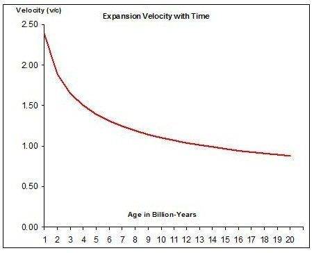

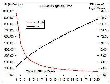

I have attached two graphs, which may be inappropriate, but I wanted to try to illustrate the nature of my questions with a model. It is a model based on the Friedmann equation minus the [tex][k/a^2][/tex] and [tex][\Lambda/3][/tex] terms:
[tex]H^2 = \frac{8}{3}\pi G \rho = \frac{8}{3}\pi G \left(\frac{M}{4/3\pi r^3}\right)[/tex]
[tex]H = \frac{1}{t} = \sqrt{ \frac{2GM}{r^3}}[/tex]
The mass of the universe has been set at [tex]8.5*10^{52}kg[/tex], which roughly corresponds to an often used estimate and leads to a present day value of [H=70.1km/s/mpc]. From these assumptions, a model of an expanding universe is calculated against time. It is believed that this model should be, at least, reflective of a matter-dominated universe existing from 1 billions after the Big Bang to the present-day?
See Graph1.jpg: H and radius against the age of the universe
The second graph (graph2.jpg) plots the velocity of the expansion, based on the size of universe at the time in question, against the age of the universe. What it seems to suggest is that the physical expansion, due to H, is initially greater than the speed of light, but this slows with the expansion, i.e. as the value of (H) falls.
So my question relates to whether this model is, at least, reflective of a basic mechanism by which the physical universe is larger than the visible universe?
Would really appreciate any insights as to how the radius of the physical horizon is calculated. Thanks
Footnote: this model does not seems to given a value of 46 billion light-years, but this may be the least of its problems.:rolleyes:
Don't entirely understand the question since why would one need a mechanism to explain the fact that the physical universe is larger than the observable universe (or the visible which is nearly the same)?
Do you mean the radius of the physical universe, or the particle horizon?
The particle horizon is the same as the radius of the observable universe and has been calculated to be 46 billion LY.
The radius of the entire universe is not known. There is no evidence that it has a boundary. It could be finite like the 3D analog of a 2D sphere surface and then it would have a finite circumference. On the other hand it might be infinite. If you would like, I can tell you how to estimate the circumference assuming that the entire thing is spatial finite

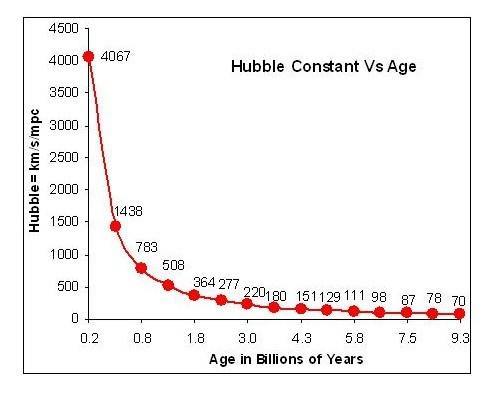

mysearch said:
Finally, are there any sources showing (H) against time (t)?
Hot off the (arXiv) press!
http://arxiv.org/abs/0807.3551" :
Enrique Gaztanaga said:
This is the 4th paper in a series where we study the clustering of LRG galaxies in the latest spectroscopic SDSS data release, DR6, which has 75000 LRG galaxies sampling 1.1 (Gpc/h)^3 to z=0.47. Here we study the 2-point correlation function, separated in perpendicular (sigma) and line-of-sight (pi) directions. We find a significant detection of a peak at r=110 Mpc/h, which shows as a circular ring in the sigma-pi plane. There is also a significant detection of the peak along the line-of-sight (LOS) direction both in sub-samples at low, z=0.15-30, and high redshifts, z=0.40-0.47. The overall shape and location of the peak is consistent with baryon acoustic oscillations (BAO). The amplitude in the line-of-sight direction, however, is larger than conventional expectations. We argue this is due to magnification bias. Because the data is shot noise dominated, a lensing boost in signal translates into a boost in S/N. We take advantage of this high S/N to produce, for the first time, a direct measurement of the Hubble parameter H(z) as a function of redshift. This differs from earlier BAO measurements which used the spherically averaged (monopole) correlation function to constrain an integral of H(z). Using the BAO scale purely as a standard ruler in the LOS direction, we find: H(z=0.24)= 79.7 +- 2.1 (+- 1.0) km/s/Mpc for z=0.15-0.30, and H(z=0.43)= 86.5 +- 2.5 (+- 1.0) km/s/Mpc for z=0.40-0.47. For a flat universe with a cosmological constant, our two measurements of H(z) extrapolate to H_0=71.7 +-1.6 km/s/Mpc. This is in remarkable agreement with previous, independent, estimates of H_0 based on fitting the cosmological constant model. Combining our measurements with external constraints on w and dark energy abundance, we find w = -0.96 +- 0.05.

As a somewhat expansive question, can we plot the expansion factor (X) of the universe in conjunction with the falling value of (H) linked to gravity alone?
Finally, the point I seem to be missing is that I can understand how the expansion of the universe may be said to curved in sense that a(t) is accelerating, e.g. 1, 2, 4, but based on equation [3], does spacetime remain essentially flat at each instance in time under the assumption that k=0? Apologises if I have missed what might seem an obvious point in your response.
