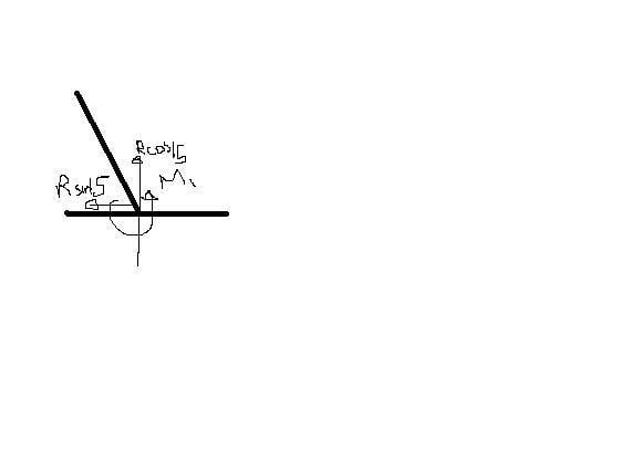

xm.. because i am student and this is the first time i am facing such problems it is little difficult to understand. I think that i get the forces on the fixed end. i attached a pic. Cheers

xm.. because i am student and this is the first time i am facing such problems it is little difficult to understand. I think that i get the forces on the fixed end. i attached a pic. CheersView attachment 24272
You have identified the moment at the fixed end support, but its direction is wrong. Can you calculate its value? Regarding the reaction force at the end, you have not correctly shown the components. Since the frame is subject to vertical loading only, what must be the magnitude and direction of the reaction force at the support? Can there be a horizontal component to it in light of the fact that there are no horizontal forces applied? Once you identify the reaction force and its direction, you can then break it into componnents parallel to and perpendicular to the sloping member. Then proceed with the moment and shear diagrams in accordance with pongo38 suggestions. You'll probably have to rotate your paper 85 degrees ccw to draw the moment and shear diagrams for that piece (or tilt your head :wink:). You should be thoroughly familiar with drawing shear and moment diagrams for simple cases (like a horizontal cantilever with uniform load distribution), before attempting to solve this problem.

maybe this helps, I don't know...you'll have to calculate P1, P2, x1, x2, M, R, and its components...and that's just the beginning...

P1 and P2 are the applied loads on the frame...P1 represents the weight from the rectangular piece of the billboad and P2 represents the weight from the traingular piece..these are downward loads on the beam (gravity acts down). In terms of upward loads, there must be upward reaction loads on the frame for equilibrium (R = P1 +P2, up), and also, for equilibrium, internal upward loads on the horizontal beam, whch you can find by taking a free body diagram of that horizontal beam. For example, if you cut it free from the slanted member at the right far right end of the horizontal beam, there must be an upward shear force equal to P1 + P2 at that cut, (plus a bending moment). If that is what you mean ...continue.

Free body diagrams must include all forces and all moments acting on the object. I chose the FBD of the top horiz beam as an example; If you took the FBD thru the appied billboard load, the forces and moments become a bit more dificult ot calculate (using Newton 1), since you cannot simply use the resultant load P1 or P2 when looking internally within that dostributed load area..
