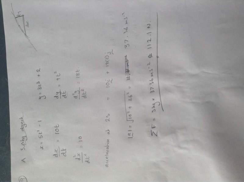

Got it! God I'm such a simpleton at times! I was inter grating when I should have been differentiating :(
