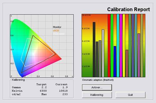

Here's an interesting review for a European model of the Quattron, notice the calibration test:
http://www.flatpanelshd.com/review.php?subaction=showfull&id=1287569264
...and a quote from AVSForum regarding the review linked:
BobearQSI at AVSForum said:
The review measures delta E, which is deviation from the correct color. A value greater than 2 is a visible deviation for the correct color. 4-5 means the color is wrong. After the best calibration of the Sharp, the values are still mostly greater than 6. The yellow value is almost 8! This means if you put a calibrated Quattron next to a TV showing the correct yellow, you will easily see a difference in the color. And that's calibrated. The uncalibrated out-of-the-box chart was greater than 10, off the chart.
http://www.avsforum.com/avs-vb/showthread.php?t=1237271&page=6
