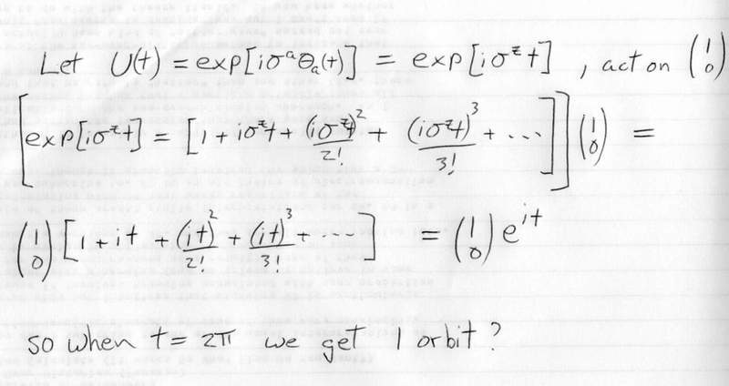

If so I wonder if a spinor times exp(iωt) could be thought of as an orbit in S^3?...
Let ω = 1 and let t = 0, at what time t do we come back to our starting place,
a) t = ∏/2
b) t = ∏
c) t = 2∏
d) t = 4∏
Thanks for any help!
a) t = ∏/2
b) t = ∏
c) t = 2∏
d) t = 4∏
Let,
[tex]U(t) = \exp [i \sigma^a \theta_a(t)] = \exp [i \sigma^z t][/tex]
act on [tex]\begin{pmatrix} 1 \\ 0 \end{pmatrix}[/tex]
Worked out below it looks like the answer is c.

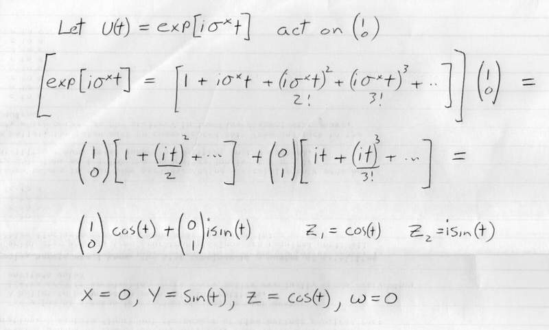

fzero said:
Yes, because [itex]SU(2)[/itex] is isomorphic to [itex]S^3[/itex]. We can represent a arbitrary [itex]SU(2)[/itex] matrix by
[tex]U = \begin{pmatrix} z_1 & -z^*_2 \\ z_2 & z_1^*\end{pmatrix}, ~~ |z_1|^2 +|z_2|^2=1.[/tex]
S^3 is the set of points in R^4 such that,
x^2 + y^2 + z^2 + w^2 = 1
I guess we can let z_1 and z_2 above be,
z_1 = z + iw
z_2 = x + iy
then |z_1|^2 +|z_2|^2=1
Now I can plot the path in S^3, z_1 = exp(it),
z = cos(t), w = sin(t)
Let,
[tex]U(t) = \exp [i \sigma^a \theta_a(t)] = \exp [i \sigma^x t][/tex]
Worked out below.
