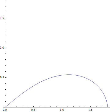

Running all of this through a numerical diff eq solver, I get the following shape. Positive x is "up". Sorry, I didn't rotate it or scale it better.
Plot of a curve starting at the origin, rising to a peak near height 0.55 at x of about 1.1, then falling steeply to the x-axis near x of 1.8; axes labelled 0.0, 0.5, 1.0, 1.5 on both.
  • Plot of a curve on axes from 0.0 to about 1.8 horizontally and 0 to 1.5 vertically, rising from the origin to a peak near y = 0.55 and falling back to the x-axis.
Graph of a curve starting at the origin, rising to a broad maximum near height 0.55 at x about 1.1, then falling steeply to meet the x-axis near x 1.8, with axis ticks at 0.5, 1.0, 1.5 on both axes.
