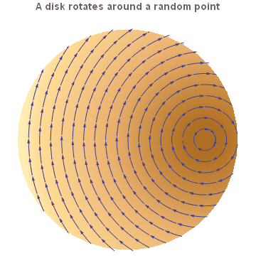

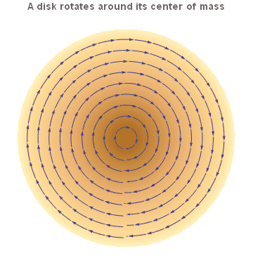

Suppose I have a rigid disk which is spinning about its center of mass. At a given instant I can plot the velocity of each point on the disk as follows:
The formula for the velocity field is ##\vec v=(y,-x)##. This is rotation around the center, as expected.

These two points are not special. In fact, for any point on the wheel you can pick a reference frame where that point is momentarily at rest. When you do so the motion is as follows:
The formula for this velocity field is ##\vec v=(y,-x)+(0,0.7)##. Notice again that this motion is momentarily a pure rotation about the chosen point which happens to be ##(0.7,0)##.
This is a general feature of rigid body motion. You can always decompose the velocity of the material points in a rigid body into a pure rotation about any point and a rigid translation.
So again, it isn't that the rotation is about the center of mass, but that the translation of the center of mass is particularly simple.

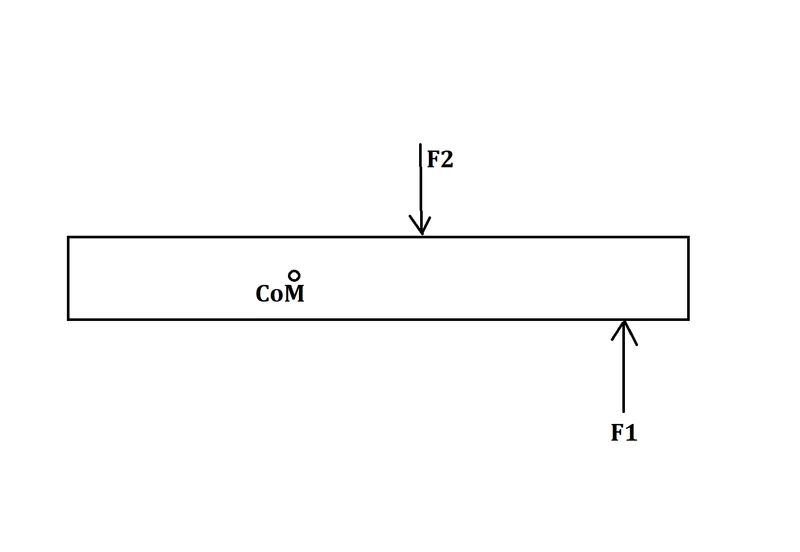

How to find pivot point for this stick, we know CoM, two forces, stick lay on table, F2 is center of lateral friction force from table surface. F1 and F2 are constant forces, not impulse
Free-body diagram of a rigid bar with its centre of mass marked CoM, a downward force F2 applied at the top surface near the middle, and an upward force F1 applied at the right end.
wrobel said:
It is a very bad idea to throw kinematics and dynamics in the same heap
how do you mean?
gen x said:
how do you mean?
I mean that one should first study kinematics and after that dynamics.

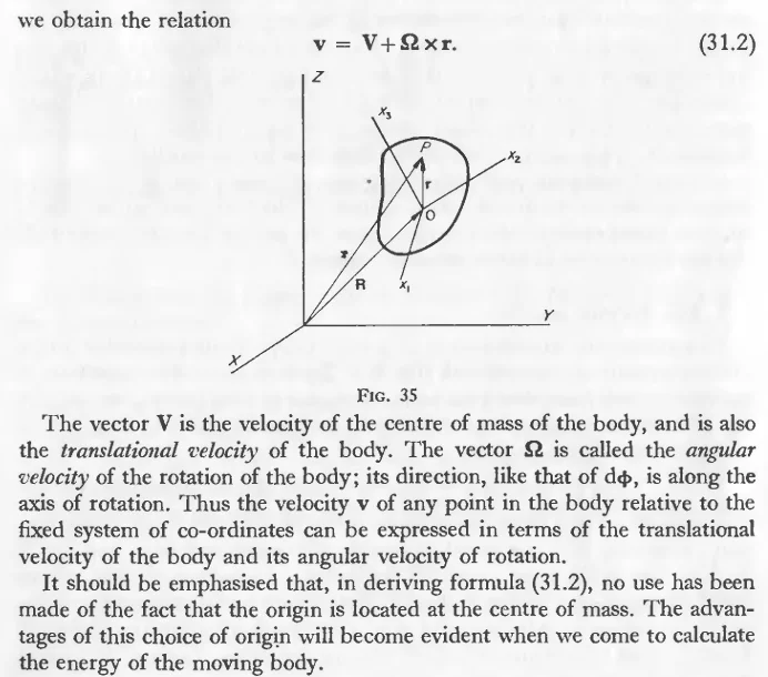

FYI Landau-Lifsitz's Mechanics explains in section 31
Textbook figure (Fig. 35) of a rigid body with a fixed coordinate system X, Y, Z and body axes x1, x2, x3, showing position vector R to the origin O, position vector r to point P, and rotation axis.
Then they investigate the case where O' which is distance a from O is taken. I recommed you to find a copy and read it.

You misunderstand. All of those plots show the same motion of the same object at the same time. In all three plots the axle is in the center of the wheel and the wheel is spinning smoothly. There is no physical difference between the three. The differences are purely mathematical. For the same rigid physical motion you can choose any point and decompose the total motion as a translation and a rotation about that chosen point.
