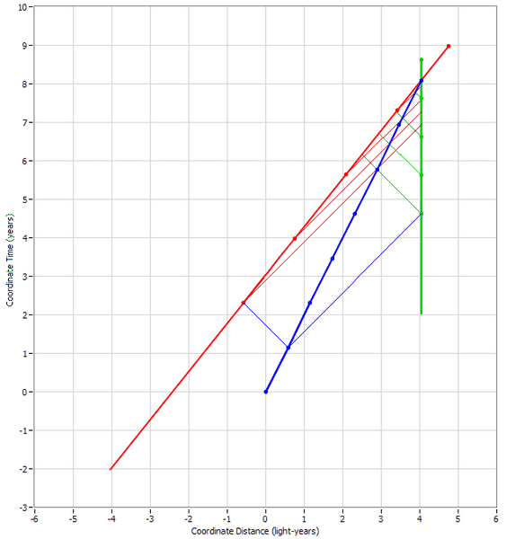

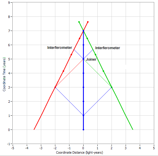

In order to make these analyses more clear, I have created some spacetime diagrams. First is the rest frame of the coordinator, shown as the thick blue line. I take up the scenario after the two boxes in red and green have been moved to a distance of 4 light-years apart. The dots represent 1-year increments of time for each observer:
Spacetime diagram with coordinate time in years on the vertical axis and coordinate distance in light-years on the horizontal axis, showing a blue vertical worldline at zero, red and green worldlines moving apart and back, and light-ray diagonals between them.
At the Coordinate Time of 1 year, the coordinator sends a blue signal to both remote boxes to start their instant accelerations towards each other and to start their stopwatches.
As you can see, they each see the other ones stopwatch sitting at zero for over two years. Then they see the other one start accelerating towards them and then they see the other ones stopwatch start running at three times the rate of their own. When they finally meet, their own clocks have advanced by about three and a half years and they have seen the other ones clock advance by the same amount of time. I think this is very clear. What do you think?

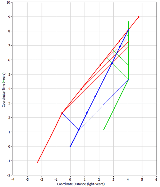

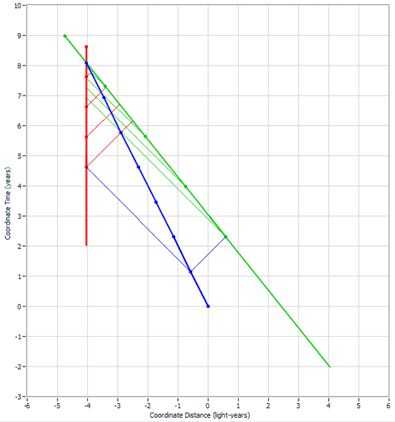

Now I will transform the scenario into the rest frame of the red box after it has accelerated to 0.5c:
Spacetime diagram with coordinate distance in light-years on the horizontal axis and coordinate time in years on the vertical axis, showing red, blue and green worldlines with light-ray segments drawn between them.
As you can see, the previous analysis of what they each can actually see is maintained in this space time diagram, but in addition, we can see the other analysis where the green box started accelerating way before the red box did and that's why both of them can accumulate the same amount of time (3.5 years) during their trips, but only the green box is Time Dilated in red's rest frame.

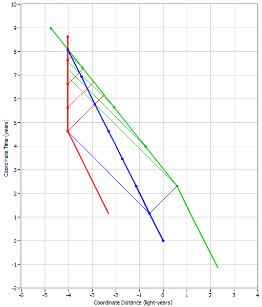

And we can transform to green's rest frame and see that the prior analysis of what each observer sees still holds true but in addition, it is only the red observer that is Time Dilated in green's rest frame:
Spacetime diagram with coordinate distance in light-years on the horizontal axis and coordinate time in years on the vertical axis, showing red, blue and green worldlines with thin light-ray lines between them.
Does this make perfect sense to you? Any questions?

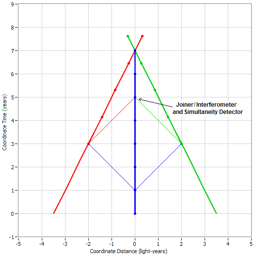

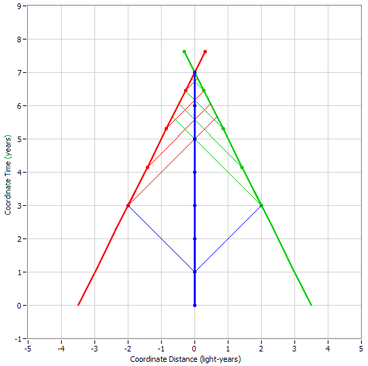

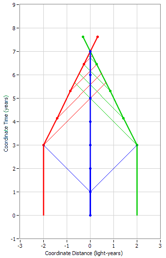

OK, I have changed your scenario so that there truly is no acceleration anywhere. The two boxes come out of infinity and have been inertial the whole way as they approach the coordinator. At some point in time, the coordinator sends out a pulse to each box to start their stopwatches. Now here are the three spacetime diagrams without further explanation (the explanation in post #17 works here just as well):
Minkowski spacetime diagram with coordinate time in years on the vertical axis and coordinate distance in light-years on the horizontal axis, showing a blue vertical worldline at distance 0, and red and green worldlines diverging symmetrically upward from the origin region, with light-signal lines drawn between them.
Spacetime diagram with coordinate distance in light-years on the horizontal axis and coordinate time in years on the vertical axis, showing a red worldline, a blue worldline and green light rays with dots and thin connecting lines.
Spacetime diagram with coordinate distance in light-years on the horizontal axis and coordinate time in years on the vertical axis, showing red, blue and green worldlines with thin diagonal light-signal lines between them.
Now is it all perfectly clear to you? No objections?

Well your spacetime diagram is a good example that there's no paradox but logic still contradicts.
The root of the solution starts from the simultaneity. You have drawn that diagram assuming the moving box receives the signal way before the observer receives the signal
So i decided to solve it from the simultaneity part
From the unboxed (blue line) observers frame each travelers receive the signals simultaneously.
There's a setup here
After receiving the signals, it reflects towards a beam joiner which is placed at the centre and that beam is sent to the box1’ interferometer (Red box) . Since according to the unboxed observers frame of reference, they must meet at the beam joiner and hit the interferometer simultaneously, therefore there won't be an interference pattern.
But when you apply simultaneity, from the red box’ point of view, the other one (green box) has already received the signal and therefore the light beams won't reflect simultaneously and will definitely form an interference pattern.
Solve this first.
If you can draw this in spacetime diagram, then it means it contradicts with logic
Solve this first.
Ibix already answered this. In all frames, the signals leave simultaneously (trivial because they are colocated), and arrive together simultaneous (same reason), but the reflections off the boxes are simultaneous only in the unboxed frame. In one of the box frames, the signal reaches the other box first, but then has longer to go to meet the other signal; the other signal reaches given box later, but then has less to go to meet the other reflected signal. Thus everyone agrees the reception will be simultaneous, but only the unboxed observer finds the reflection events to be simultaneous.
