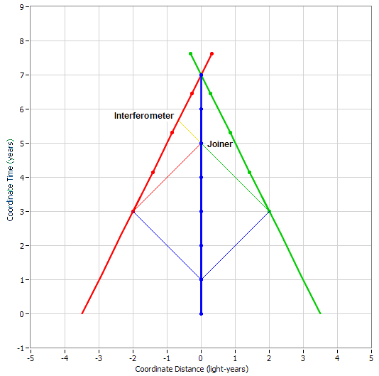

I have no idea what you have in mind. If I just read what you wrote, you are describing a scenario that looks like this, correct?

You have to first tell me if I drew the spacetime diagram according to what you had in mind. I think I drew it according to my best understanding of your description.

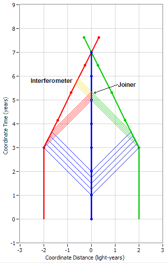

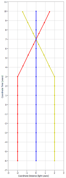

I get the impression that my previous diagram was not correct:
Spacetime diagram with coordinate time in years on the vertical axis and coordinate distance in light-years on the horizontal axis, showing a blue vertical worldline at distance 0, red and green diagonal worldlines of two boxes moving apart, a joiner at time 5, and two interferometer beam paths forming a diamond from events at time 1 and time 7.
Instead, I think this is really what you are describing:
Spacetime diagram with coordinate time in years on the vertical axis and coordinate distance in light-years on the horizontal axis. A vertical blue line marks the coordinator at distance 0, with a thick red and a thick green line diverging outward, and thin red and green paths forming reflections at distance plus or minus 2 at time 3.
I think you are saying that in this frame, there is no interference pattern because the two beams sent from the coordinator are symmetrical and simultaneous throughout their trips, including their simultaneous reflections and simultaneous arrival back at the coordinator but when we transform to the rest frame of either box (red or green), there will be an interference pattern because even though the two beams arrive at the coordinator simultaneously, they didn't reflect simultaneously and didn't follow simultaneous equal distant paths, is that correct?
So if I can show you that there is no interference pattern in both the red and green rest frames, then you will be convinced that there is no logical contradiction, correct?
  • Minkowski spacetime diagram, coordinate time in years against coordinate distance in light-years, showing a blue vertical worldline with a red and a green beam path forming a V pattern meeting at a joiner at time 5, with reflection points at distances of plus and minus 2 light-years.
But you have already shown me that there is no contradiction. Your spacetime diagram was perfect. But i just need an answer to my last post
Your second diagram is not right. The beam joiner is at the middle but the interference detector is placed only on the red box. It goes like this
The reflected light from green box and red box meets the beam joiner, then they combine and move towards the red box interferometre

I guess my first diagram was almost correct, I just added a second interferometer by mistake. Here it is with only one interferometer and I made the joined green and red signals appear as yellow:
Spacetime diagram with coordinate time in years on the vertical axis and coordinate distance in light-years on the horizontal axis; a thick blue vertical worldline, two red and green diagonal worldlines crossing it, a yellow segment labelled Interferometer and a point labelled Joiner.
Is this correct?
If so, then is your concern that in the blue coordinator's rest frame, the interferometer will not detect an interference pattern but in the red box's rest frame it will? And if that is your concern, and I can show you that there will not be an interference pattern, will you agree that the logic does not contradict and we will be done with this thread?
  • Spacetime diagram with coordinate time in years on the vertical axis and coordinate distance in light-years on the horizontal axis, showing a blue vertical worldline, red and green worldlines moving apart, a yellow segment labelled Interferometer, and a light-ray path labelled Joiner.

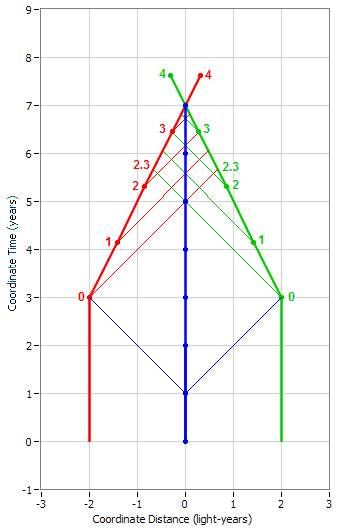

Yep, this is exactly what I was describing in post #48.

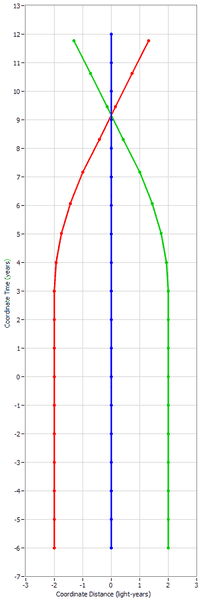

I wrote my own application using LabVIEW by National Instruments. What I did in LabVIEW presumably could be done in any programming language but since I don't know any others (and don't want to learn any others), I did it in the one I have been using professionally for over two decades.
Your previous space time diagram was correct. Or do you want to post it again? Whatever I'm sure your spacetime diagram will look like this again
  • Spacetime diagram with coordinate distance in light-years on the horizontal axis and time on the vertical axis, showing red, blue and green worldlines with dashed simultaneity lines.

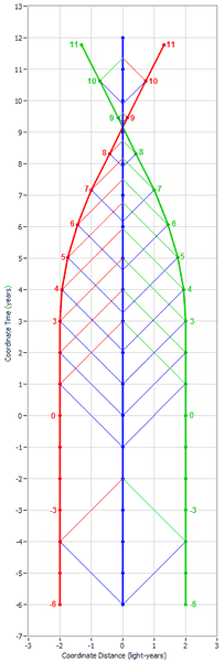

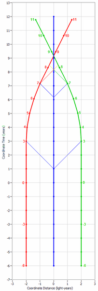

OK, we'll go with the acceleration version.
Here's the blue coordinator's rest frame showing how the interferometry would work. If it was real interferometry of visible light, it would be on too small a scale to distinguish any features so I have, in effect, used a one-year long light signal that has a period of three months. The five thin blue lines emanating from the blue coordinator represent the peaks of this very low frequency light:
Minkowski spacetime diagram of coordinate time in years against coordinate distance in light-years, showing a vertical blue worldline with light-signal lines bouncing between red and green worldlines that meet at a Joiner point.
As you can see, the light hitting the moving reflectors on the red and green boxes causes a Doppler "blue" shift in the frequency (higher) or wavelength (shorter) of the light but since it is symmetrical, the Doppler shift is the same for both boxes and is received by the Joiner coherently and passed on to the Interferometer in the red box with no interference (as you say), meaning the peaks of the reflections from both boxes arrive simultaneously at the Joiner and passed on to the Interferometer.

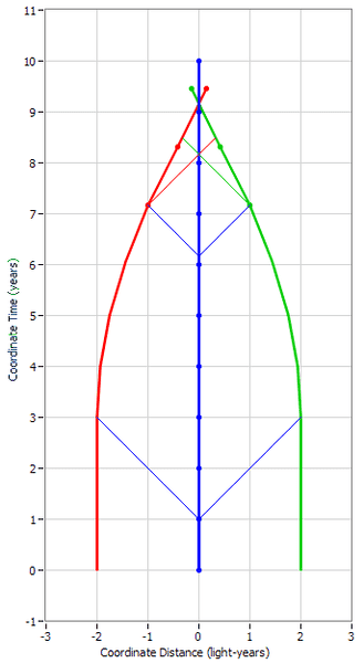

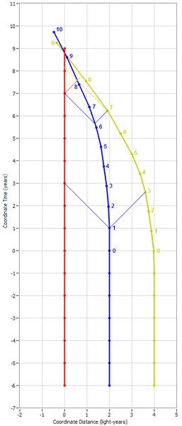

Now we transform to the rest frame of the red box:
Spacetime diagram in coordinate time (years) against coordinate distance (light-years): blue, red and green worldlines with thin light-signal lines and a point labelled Joiner at about (-3, 6).
As you can see, the signals leaving the blue coordinator start out Doppler shifted in opposite directions. Going to the red box, the signal is Doppler blue-shifted (higher frequency) and the signal going to the green box is Doppler red-shifted (lower frequency). But the signal bouncing off the red box doesn't get any further Doppler shifting, it has the same frequency as the sent signal. However, the signal bouncing off the green box gets a lot of Doppler red-shifting making it an even higher frequency than the signal reflecting off the red box. But this signal passes right through the Joiner without any more Doppler shifting while the signal from the red box gets Doppler red-shifted some more so that it ends up exactly in sync with the reflected signal from the green box. As a result, the interferometer in the red box detects no interference pattern, just as in the original rest frame.

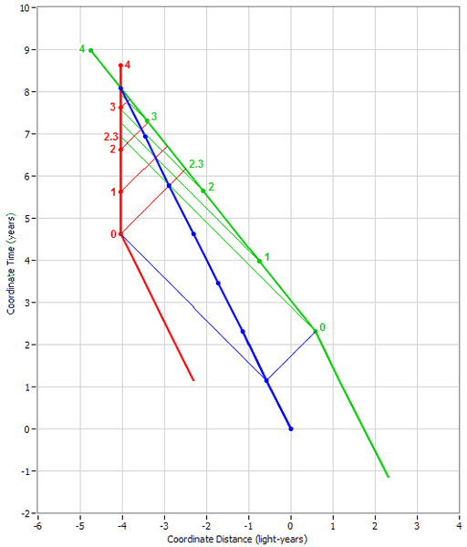

Does this make perfect sense to you? Any questions or further concerns? Can you see that it is logically consistent and there is no contradiction?
  • Spacetime diagram in coordinate time (years) against coordinate distance (light-years): blue worldline with yellow and red light-ray lines meeting at Joiner, and a green worldline, with an Interferometer label.
  • Spacetime diagram in coordinate time (years) against coordinate distance (light-years): a blue vertical worldline at distance 0 with red and green worldlines moving apart from and back toward it, forming a light-signal grid between them.
We reached the same conclusion before the #42nd post. Now answer my #42 question?
