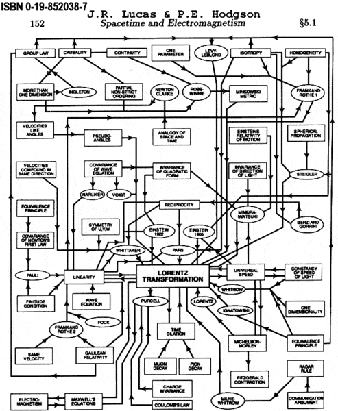

You can probably apply a symmetry argument. I recall (from Mermin's little book?) an argument explaining why there is no "length contraction" in the perpendicular directions. Suppose each observer had an arm of rest length L along their transverse y-axes, with some marking device (like a pen) at the far ends. When they pass each other (assuming they are properly lined up), they would mark each other inconsistently if the transverse arms were affected by their motion.
From googling, here is a similar argument involving a hole and a bullet, part 5 in
http://cmtw.harvard.edu/Courses/Phys16/l1_latex/l1_latex.html
I think this paper is actually not as much a formal derivation as a somewhat arm-waving classroom demonstration. As such its aim is not to convince but persuade. Maybe it's also a challenge to the students to come up with just the kind of questions we have created here.
This is one of those "Lorentz Transformations without the speed of light" proofs where the value of the speed of light plays its role only in the last step. Of course, some other set of assumptions must be invoked and weaved into the storyline.
Depending on one's tastes on what one regards as fundamental or primitive or even "known by intended audience" (e.g. group structure? causal structure? electromagnetism? projective geometry? experimental facts?), one may or may not like these various approaches.
I have attached a chart from "Spacetime and Electromagnetism" by J.R. Lucas, P.E. Hodgson ( ) where they try to diagram the various approaches to obtain the Lorentz Transformations. [Certainly, the chart is not complete... but merely representative.]
Search the American Journal of Physics (http://scitation.aip.org/ajp/ ) for specific papers. Try to search for say, Lorentz, in the keyword field. WOW! You can now search all the way back to the first issue from 1933... and download articles (for free, if your school has access).
My personal favorites (in the terminology of the chart) include pseudoangles, Michelson-Morley, radar, metric, and causality/partial ordering.
PS: If the goal is to move on to GR or beyond, where many of symmetries enjoyed by Minkowski spacetime are not available, some of these approaches might not be so easy to extend.
My $0.02.
There is an article in there about things like extinction in the MMX experiment etc. It seems very complete and a very interesting read when I get around to it.
