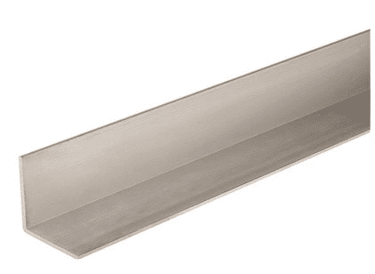

Here is a link to the exact product.
https://www.homedepot.com/p/Everbilt-1-in-x-96-in-Aluminum-Angle-with-1-16-in-Thick-800057/204325583#product-overview
It doesn't like me ?
Other websites reveal it's an L-shaped profile like
which you cannot bend yourself without it losing its strength.

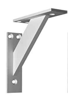

I think you are selecting angle aluminium because it is easy to drill and conceptually seems to fit the angle between the wall and the shelf. But it will be too thin and will not support the shelf without some diagonal bracing. You should consider making a diagonal bracket that will fit below the shelf.
Search 'shelf bracket' to find things like …
https://www.homedepot.com/p/Everbilt-20-in-x-13-in-White-Heavy-Duty-Shelf-Bracket-14825/202895666
An alternative would be to hang the shelves on ropes or wires from a structure above, or with diagonal rods or wires from wall attachments. You could use aluminium angle to tie the shelf to the wall, but it would not carry the weight. What structure is available in, or above the wall.

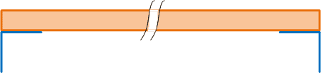

It took me a good night's sleep to finally grok the setup :rolleyes: . Let's check:
You have two sides 4' apart (a door opening, cabinet sides ? or indeed plaster or cardboard wall ?) and in between you want to install a 2' x 4' x 1/2" plywood shelf, supported by two aluminium L profiles. Front view:
( I was so stuck in the wall-mounted idea that I missed your 24" meaning o:) )
15 lbs per 24" profile will probably hold, but personally I would want considerable reserve (testing with a gallon of water requires that for sure).
Two 4" brackets in the back wall at 16" from the sides won't do very much, except prevent the back edge from sagging. Then there still isn't anything that keeps the front edge from sagging, even from the shelf's own weight alone. How about a 1" x 2" pine strip under the front edge to provide some stiffness (and better looks) ? And then perhaps another under the back edge? And 2" x 2" pine strips instead of the aluminum supports ? (If the walls can handle it -- did I ask for the reason you want to save weight ? -- it seems so out of place in the plant context)
