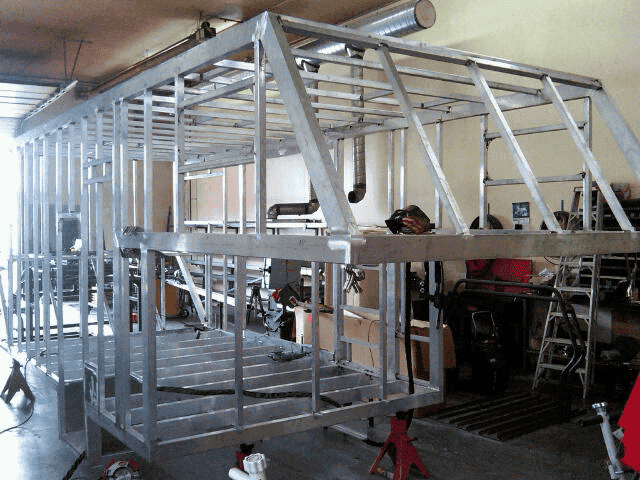

I am building a cab over slide in truck camper out of closed cell foam, fiberglass and an aluminum skeleton. The sleeping area in the cab overhang will be extended 4 1/2 feet over the cab beyond the vertical support behind the cab. The aluminum supports will run along each side of the overhang (7 1/2 feet wide) all the way to the back of the truck. The weight will also be suspended from the roof which runs from front to back. I’m trying to determine correct gauge and shape of aluminum supports.
(Continuing from the summary...)
I want to build this safely, so I am putting this out here for expert advice. My choice for the shape for the aluminum cantilever is angle, T, square tubing or round. The foam is 2” thick, so I’d like to keep the supports at 2” in width and height. I need to support the weight of 2 people sleeping as well as the portion of the camper above the cab. I figure 450lbs. for 2 adults max and 50 pounds for the weight of that portion of the camper. I assume a little bit of the weight will be suspended from the 1/8” aluminum angles running from front to back at the 2 edges of the roof and walls front to back.
So to support 500 lbs. in a cantilevered sleeping zone with decreasing weight as it moves forward from the cantilever starting point, would 2” x 2” aluminum square tubing on each edge of the cantilever front to back be enough to support the weight? My choices are 6061 alloy T6 temper or 6063 alloy T5 temper. The thickness of the aluminum is 1/8”, 3/16” or 1/4”. I want to be safe for sure, but don’t want to overkill as each pound is accounted for in this ultra lite camper. Thanks for any advice.

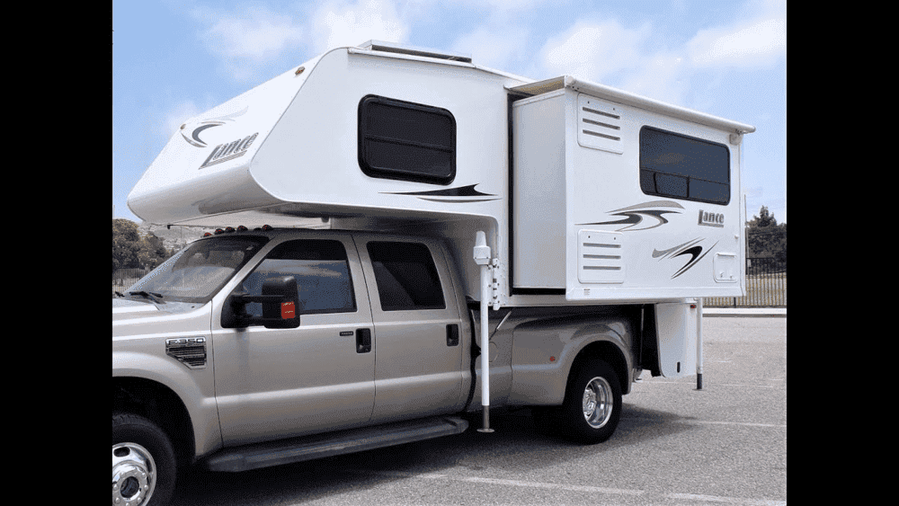

I'm not familiar with cab-over camper construction, but I was surprised by your cantilever comments. Is that common or unusual? For general structural reasons, I would expect that most cab-over campers would rest some of the weight of the overhang on the cab rooftop.
The cab rooftop is built pretty strong after all by the pickup truck manufacturers in order to meet roll-over safety tests, so it should be fine to use to support the cab-over sleeping area. You'd want to make the contact areas easy on the paint on the roof, but that problem must have been solved already, no?
EDIT/ADD -- Although looking at the image that I found, maybe a cantilever design for the overhang is common? I don't see any contact with the roof of the cab in the picture...
https://i.ytimg.com/vi/QKfkR_E1MnU/maxresdefault.jpg
The photos on this website may give good clues for the construction. Looking at it, I get the idea that structural strength is all in the wood, and that the aluminum is just a skin.
https://www.glen-l.com/campers/fairhaven-constr-3.html
But I also found this. You can almost get dimensions from the picture.

We do not have the information required.
The frame or truss structure must be defined before a stress analysis can be done. We do not know what style of space frame you will use, so we can't guess at the material requirements.
The load points on the bed of the vehicle need to transfer forces to the beams that carry those forces forwards and upwards, to be distributed, providing support under the cantilevered load.
For maximum strength for weight that structure should be diagonal and triangulated, not orthogonal as shown in post #5 image.

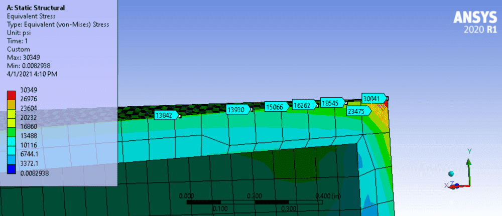

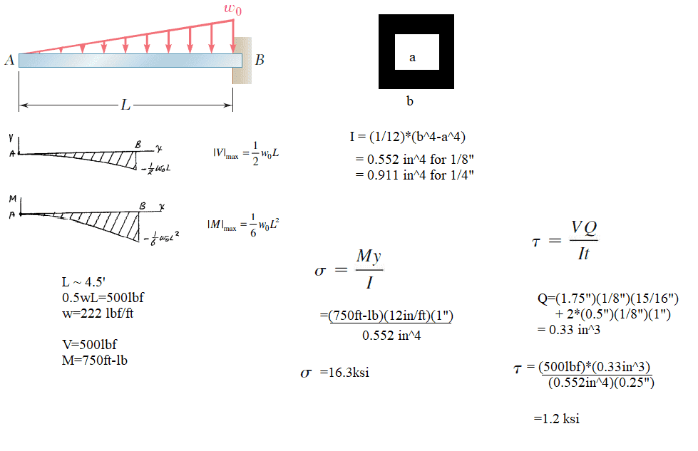

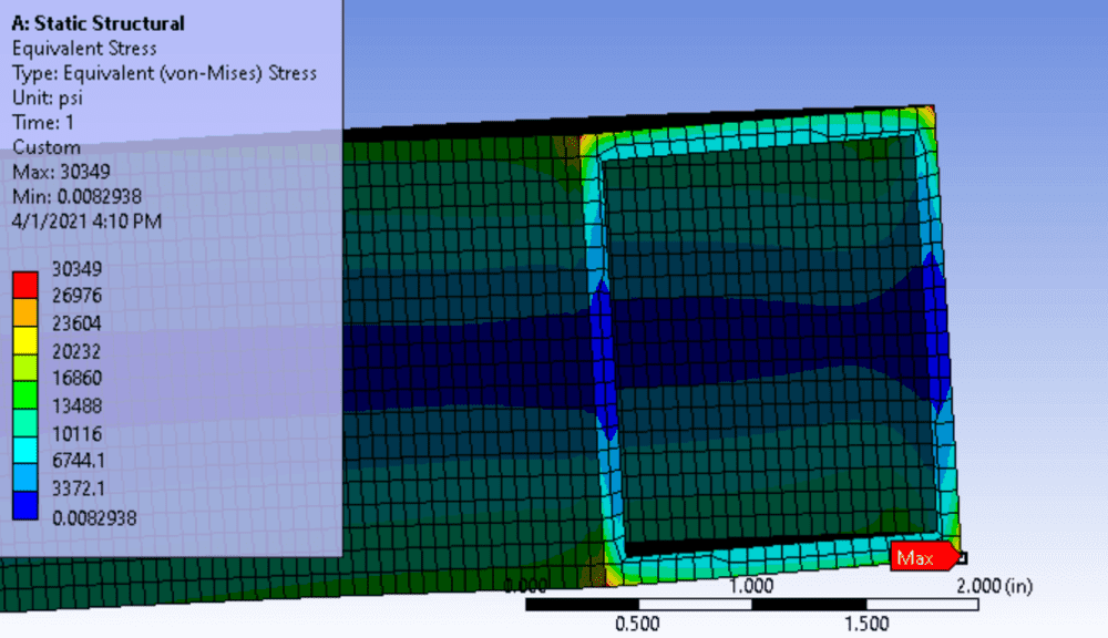

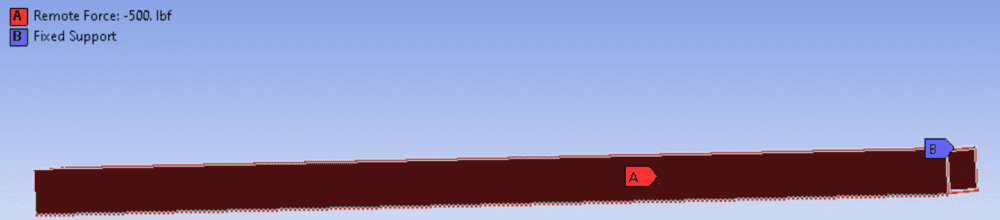

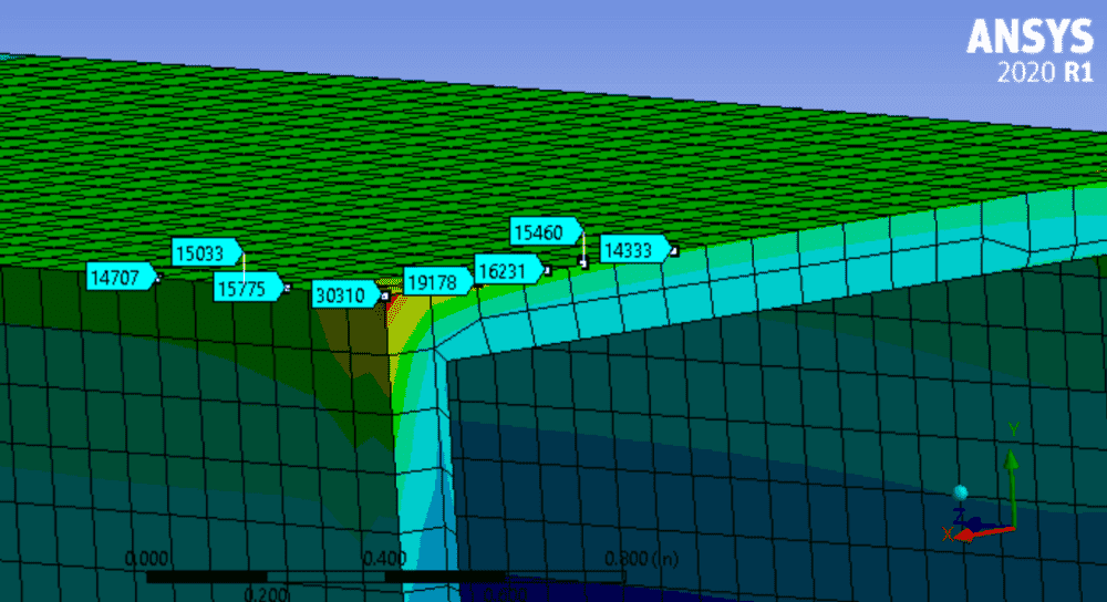

I generally agree with the sentiments so far in the thread: it's necessary to have a more complete picture of the loading scenarios. I imagine even wind could stress your structure a fair amount when traveling at highway speeds. You'd have to think about your joints (bolted? welded? - both introduce stress concentrations / heat affect zones), vibrations, fatigue life (aluminum doesn't exactly have an endurance strength like steel)...
Doom and gloom aside. I think your question is reasonably concise, so I've worked a bit of it out for you below. Assuming a linearly decreasing load on a single cantilevered beam (which is more or less equivalent to a point load @ a distance of 1/3 L from cantilever), 2" square tubing (and the more calc-conservative thickness of 1/8"), I find a bending stress of 16.3ksi and shear stress of 1.2ksi. These maximums both occur at the fixed end, though the bending stress is highest at the top and bottom, whereas the shear is highest in the center of the cross-section. Probably you would want to combine these into an equivalent von mises stress...
McMaster lists the yield strength of 6061 @ 35ksi and 6063 @ 16ksi... ~25% higher cost for twice the strength at the same weight is a no brainer for me.
You'll see the corners behave as stress concentrations, egged on by artifacts of the boundary conditions.
