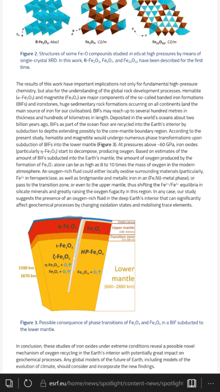

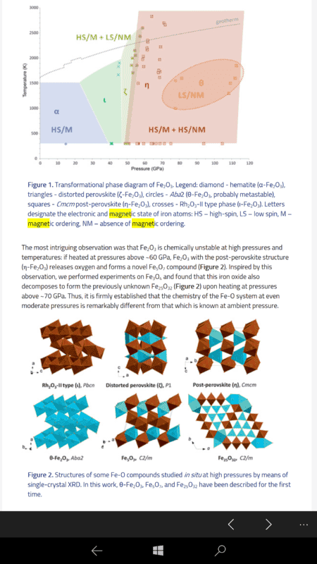

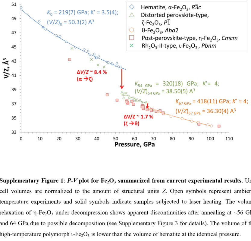

iron oxides, under extreme pressure, actually have the right density, electrical conductivity and high spin magnetically ordered ferromagnetism required for the core
if iron oxides are thought to be prevalent in the lower mantle and outer core, it's not a leap to suggest that they reside in the inner core too?
https://www.esrf.eu/home/news/spotlight/content-news/spotlight/spotlight248.html
