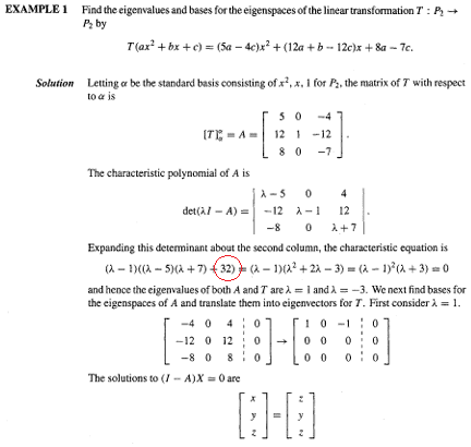

where does 32 (red) come from ?
nevermind looks its (-8)(4)=-32
but will probable have more ? on this example
Expanding on the second column we have
$\left|\begin{array}{ccc}\lambda- 5 & 0 & 4 \\ -12 & \lambda- 1 & 12 \\ -8 & 0 & \lambda- 7\end{array}\right|$$= -(\lambda- 1)\left|\begin{array}{cc} \lambda- 5 & 4 \\ -8 & \lambda+ 7 \end{array}\right|$$= -(\lambda- 1)[(\lambda- 5)(\lambda+ 7)- (-8)(4)]$$=-(\lambda- 1)[(\lambda- 5)(\lambda+ 7)+ 32]$.
The "32" comes from the -8 and 4 in the original matrix.
