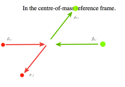

Why are the Center of Momentum velocities of masses after a 2D elastic collision anti-parallel? (as in the following diagram)
Diagram of a two-body collision in the centre-of-mass frame: red and green dots with arrows showing incoming momenta p1 and p2 meeting at a central point, and outgoing momenta p'1 and p'2 leaving in opposite directions.
CM_Velocity = (∑m_i*v_i)/(∑m_i)
This is not actually a problem I have to do. I am just looking for a proof of this fact. I have not been able to find one online, but have probably been looking in the wrong places!

What is the velocity of the CM in the centre-of-mass frame of reference? What does it mean for the colliding particles, how are their velocities related?
