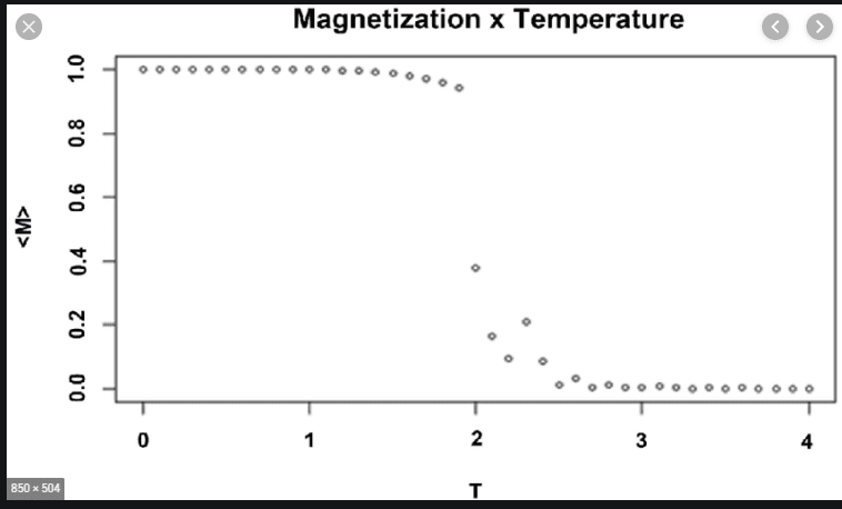

Make a chart based on magnetization and temperature for 2d ising model
none
Hi, I've been given a homework to do based on 2D Ising model.
Ive already read plenty of articles bout 2d ising model but I'm not fairly certain about some things.
I got to do a chart similar to the one I attached. Correct me if I am wrong, but on the Y axis, I have to put average of magnetization of the part where "demon" energy is already stabilized and on the X axis put the "temperature"?
Moreover, to get a chart like this, do I have to put temperature, or temperature divided by critical temperature on X axis? Also, how am I supposed to count the "temperature" having energy, demon energy and magnetization?
If I didn't explain my problems completely, feel free to ask me more.
Thanks in advance for any support

The „temperature“ on the x-axis has generally to be read as ##T/T_0##, where ##T## is the absolute temperature and ##T_0## is defined as: ##T_0=J/k##. Here, ##J## is the the exchange energy in the 2D Ising model and ##k## the Boltzmann constant.
http://farside.ph.utexas.edu/teaching/329/lectures/node110.html
Thanks dude, really appreciate it.
