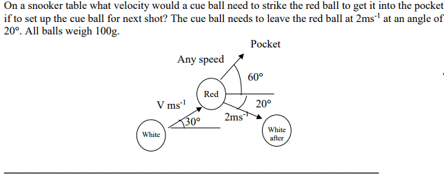

1.
[/B]
P = mv
[/B]
VCos(30) + 0 = nCos(60) + 2Cos(20)
VSin(30) + 0 = nSin(60) + 2Sin(20)
where I let n = any speed,
I'm not sure if my attempt at the solution is correct.
Theudius said:
1. View attachment 211369
[/B]
P = mv
[/B]
Check signs in 2nd equation.
I don't see anything wrong with the signs in the second equation could you explain further also how would I obtain V?
What direction does the cue ball go after impact?
2 equations, 2 unknowns.[/QUOTE]
The final angles are ##+60^o## for red and ##-20^o## for white.
