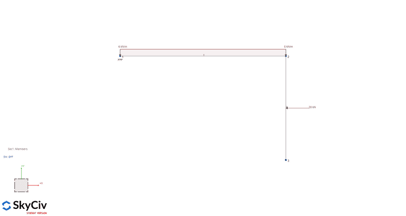

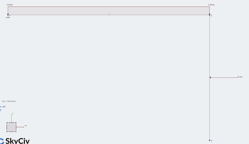

Dear all
I am trying to find the support reactions on the following structure:
Frame structure diagram from SkyCiv software: a horizontal member labelled 1 with a distributed load of 6 kN/m on top, pinned support at the left end, joined at a corner to a vertical member with a 20 kN horizontal point load and a fixed support at the bottom.
The frame member in the horizontal is 8m long and in the vertical the member is 5m.
To do this I am using the force method (or unit load method or virtual work method).

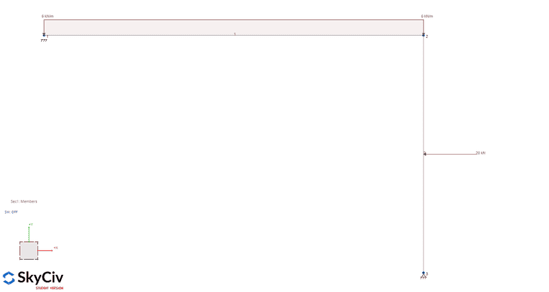

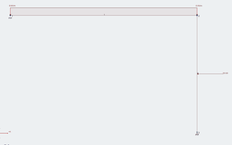

Firstly, I removing the redundants at the pinned support to make a statically determinant frame as shown below:
Frame diagram in SkyCiv: horizontal member labelled 1 from node 1 at the left, pinned support, to node 2 at the top right; vertical member from node 2 down to node 3 at the bottom, with a 20 kN horizontal load at node 2 and 8 kN/m distributed loads on the horizontal member.

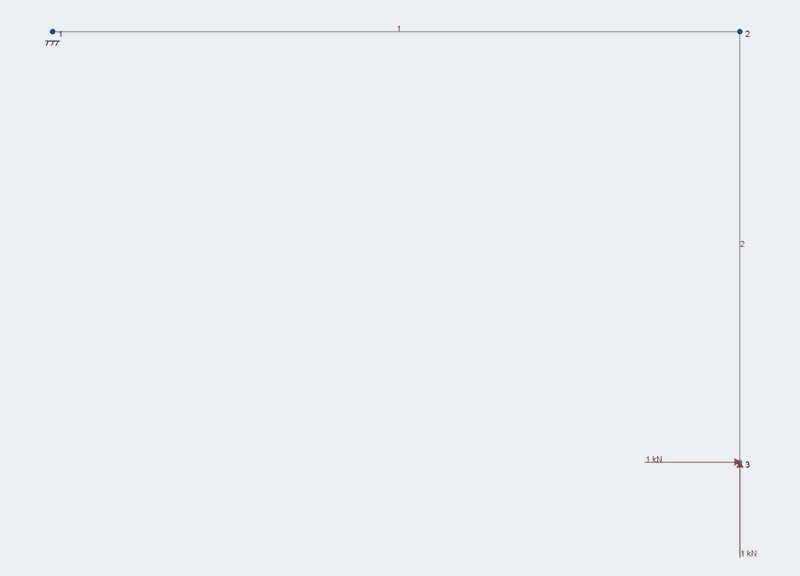

Next, I apply units loads in place of the pinned support that looks like this:
SkyCiv student software view of a two-member L-shaped frame: a horizontal member labelled 1 with node 1 at its left end, a vertical member labelled 2 down to node 3, a red horizontal load labelled 3 kN at node 3 and a red 3 kN downward load below it.

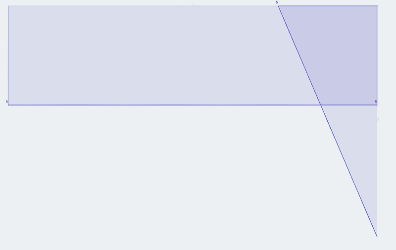

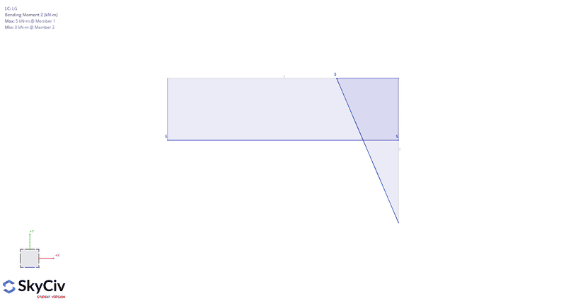

Firstly, lets consider the horizontal unit load. I need the displacement in the parallel and perpendicular directions as a result of this horizontal unit load.
Calculating the horizontal displacement as a result of this load is no problem. It is simply the sumof the integration of the bending moments.
SkyCiv bending moment diagram (Z, kN-m) for an L-shaped frame, showing a horizontal member with a straight sloped line dropping to a vertex below the right end; load case LC1, max 5 kN-m at Member 1.
So, the moment functions are: Mx = -1*x and Mx = 5. Hence, the integration to compute the delection in the horizontal direction is
Equation for horizontal deflection: delta_x = (1/EI) times integral from 0 to 5 of (-1x)^2 dx plus (1/EI) times integral from 0 to 8 of (5)^2 dx.

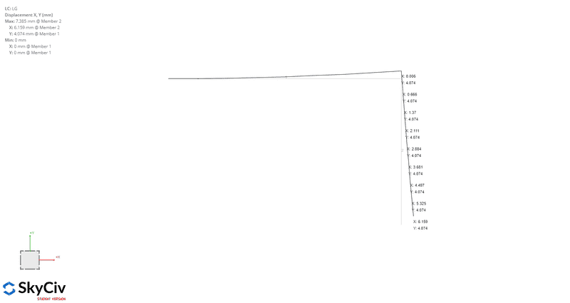

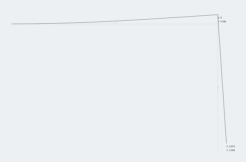

The area where I am a little stuck is computing the vertical deflection as a result of the horizontal unit load.
If you see here from the software the vertical displacement is 4.074 mm.
SkyCiv software displacement plot for LC 1G showing a horizontal frame member deflecting, with node labels giving X and Y displacement values in mm, and a support symbol with axes at the lower left.
So my question is: how do I calculate this displacement using the force method?

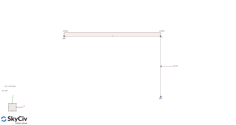

Frame:
Structural frame diagram: horizontal member 1 with uniform load 6 kN/m, supported by pinned joints at both ends, joined at the right to a vertical member with a 20 kN horizontal load at mid-height and a fixed support at the base.
Statically Determinant Frame

Application of Unit Loads:
Line diagram of an L-shaped frame with nodes 1, 2 and 3, a horizontal member 1 and vertical member 2, a support marked 777 at node 1, and a 1 kN horizontal load and 1 kN vertical load applied at node 3.

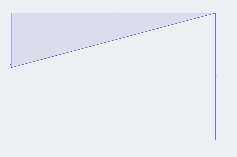

Bending Moment diagram for horizontal unit load:
Bending moment diagram of a rectangular frame: a horizontal top member with a diagonal line from its upper edge down to the lower-right corner, forming a triangular area below the beam and a shaded triangle on the right.

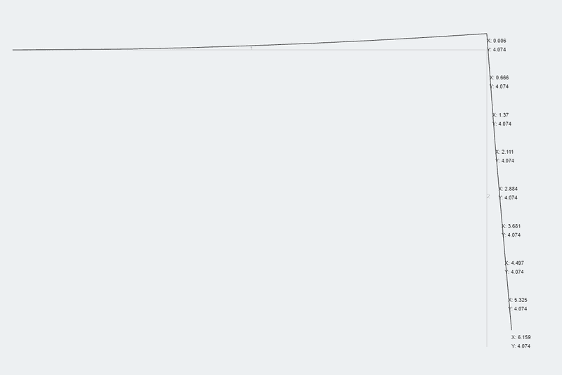

Displacement for horizontal unit load:
Line plot of a curve with a point labelled X: 0.006, Y: 4.074 at the top, descending steeply to a point labelled X: 6.159, Y: 4.074, with intermediate points labelled at X values 0.666, 1.37, 2.111, 2.884, 3.681, 4.497 and 5.325, all at Y: 4.074.

Displacement for vertical unit load:
Deflected shape plot of a frame: a curve from the left rises gently to a corner at the top right, then drops steeply to a point at the lower right, with coordinate labels X: 4.074, Y: 4.349 and X: 0, Y: 4.346.

The numbers can't be clearly seen still.
I see that the diagrams shown the deformation do not match how the structure would really deform.
Hinge 3 can't move horizontally and joint 2 can't move upwards.
The beam located next to 1 can't remain horizontal due to the distributed load.
The angle of joint 2 should remain more or less 90°.
