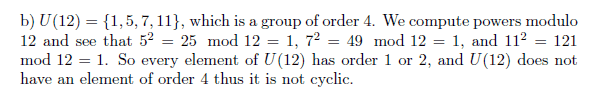

ok I found this for u(12)
where does {1,5,7,11} come from? I see that 1+11=12 and 5+7=12
also "every element of U(12) has order of 1 or 2" where does 2 come from
also from this does it mean that
U(3)={1,2} and u(5)={1,4}
