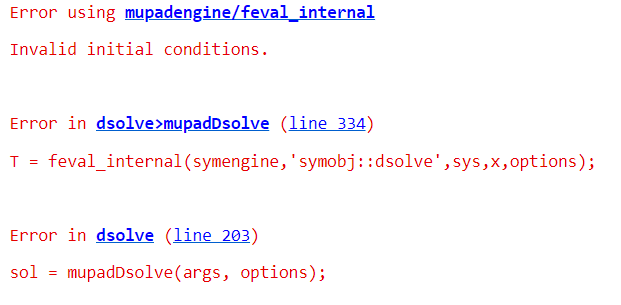

I am trying to solve the following set of 5 first order ODEs with ICs but I get an error output "invalid ICs". What am I missing?

(Note that there is a typo in the above ICs; it is ##v## instead of ##u##). I am following this solved sample, following the exact same steps. However I get an error
Are these 3 ICs not enough?

[uSol(t), vSol(t), wSol(t), xSol(t), ySol(t)] = dsolve(odes,conds) %Code breaks down, giving the output "Invalid initial conditions"%

I think the code is telling you that you initial conditions are inconsistent. What if you try taking the "ugly" solution you got without the initial conditions and apply the initial conditions one at a time?

I already found that the above method won't work, because this supposes an analytical solution can be found in Matlab. We'll need to implement a numerical solution, and we'll have to use the ode45 function or similar in Matlab.
