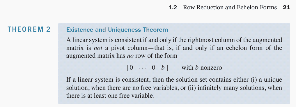

ok here is the theorem I think we need r3 is a pivit row

I don't know why you are giving the definition of a system of equations being "consistent". The exercise in your first post says nothing about a system of equation nor "consistency".
